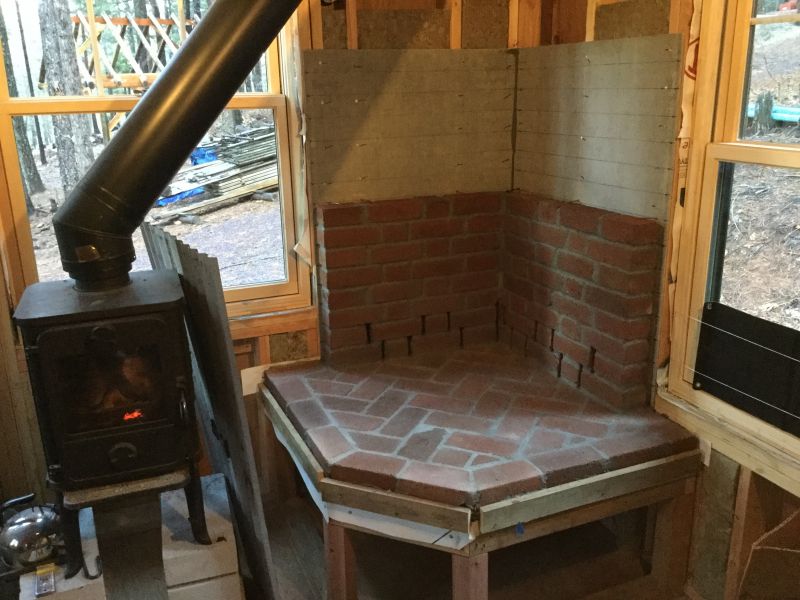

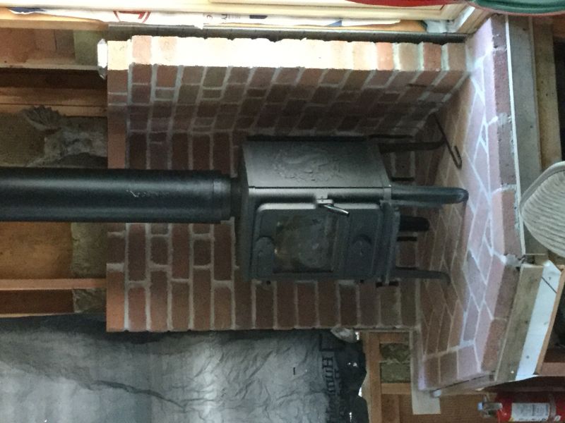

 The manufacturer will tell you what minimum clearances the stove can have to combustibles, then you can reduce those clearances by certain amounts using different methods. If you are getting it inspected, the reduction method must be approved by the inspector. One such method is the masonry with air gap method. It's usually done with brick, which will stand alone apart from the wall with the use of masonry keepers, metal tabs that nail to the wall and then fit between the bricks in the mortar, attaching it to the wall. Usually such a brick surround will be required to have a substantial number of gaps along the bottom to let in air, a one inch air gap behind, the sides and top open and unobstructed. Not sure if a mantle would work. Not sure if this method can be used with veneers such as you describe, which are meant to be attached to a substrate on the wall. I used the brick method which let me push the woodstove into the corner as far as possible
 |  Finished result
 |  In progress

 Installing brick with an air gap is an accepted means of reducing standard clearances, just as is shielding. The instructions to my woodstove state that in a corner installation, the minimum clearance to combustibles is 14". Then, it says that you can reduce that clearance using whatever approved method, but in no case can there be less than 8" to combustibles. The local building department allows a 2/3 reduction in clearance when using the brick-with-gap method, 2/3 of 14 is about 9-1/2 and leaves about 4-3/4". But since the instructions say in no case less than 8", that's what I used. I maintained 8" to the plane of the studs behind the brick.
