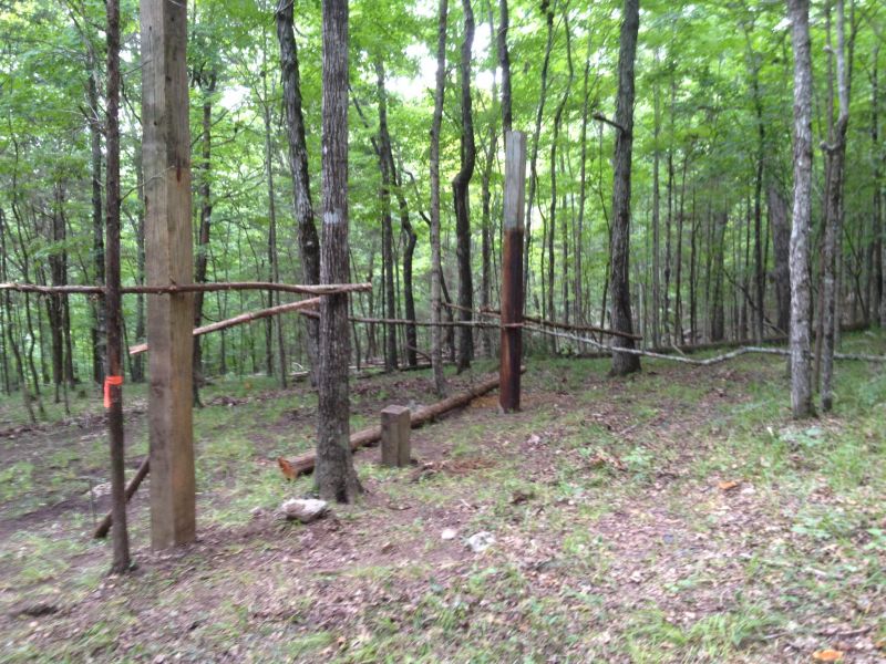

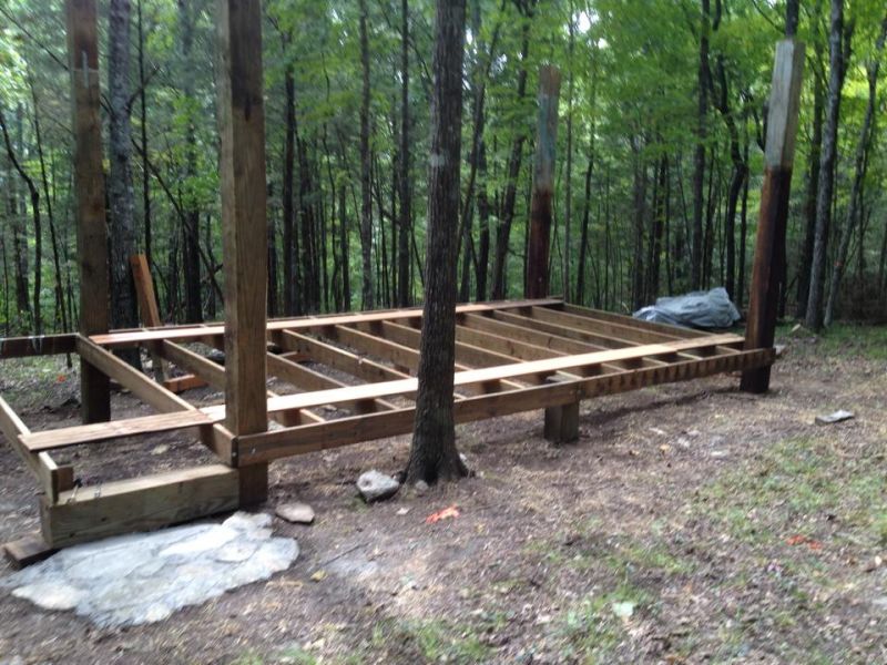

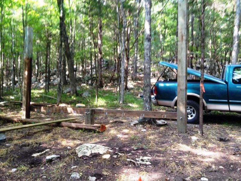

Littlecooner
# Posted: 17 Aug 2017 09:36am
a few photos of my posts in place.
