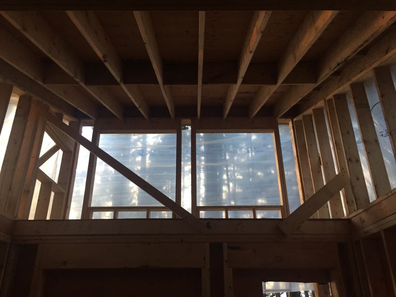

I have a 16x20 cabin with and loft and a 3/12 single pitch roof that I'm in the midst of putting up. Initially I was planning on not insulating it, but have changed my mind. In any case, I'm now wondering about suggestions/options for insulating and venting the roof as this is my first roof build.
Rafters are 2x10, roof is 5/8 plywood with novaseal underlay and steel roofing (see pics). I'm planning on installing T&G soffiting. I live in eastern Canada, and will mostly be using the cabin in the summer/fall, but also now and then in the winter. It will be wood stove heated. Obviously since I'm already pretty far into the build my options are somewhat limited, but would be interested in what approaches people would use.

About the same as the R value of those giant windows using Closed cell spray foam.

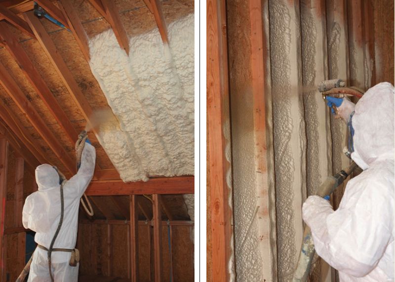

The EASIEST (though perhaps not the cheapest) option is to spray foam the underside of the roof sheathing, put up a sealed poly vapor barrier and then your ceiling finish. No vents, baffles or access holes.
I would order a Tiger Foam kit and spray it yourself. When you're done, send the empty tanks back for recycling. The spray foam is insulation and vapor barrier all in one and your roof needs no venting. Spray it and forget about it.

Spray foam is the best option; not in price, but in time, function and results.

Those two big windows form part of the roof as far as heat containment goes. Two inches (~$370) of Green 602 spray foam would provide about R14 and seal against moisture. Then vapor barrier and finish ceiling would trap air also providing more R value. Anymore insulation in the ceiling might be just a waste considering the R value of the windows. I don't know why a cathedral ceiling would be vented.
