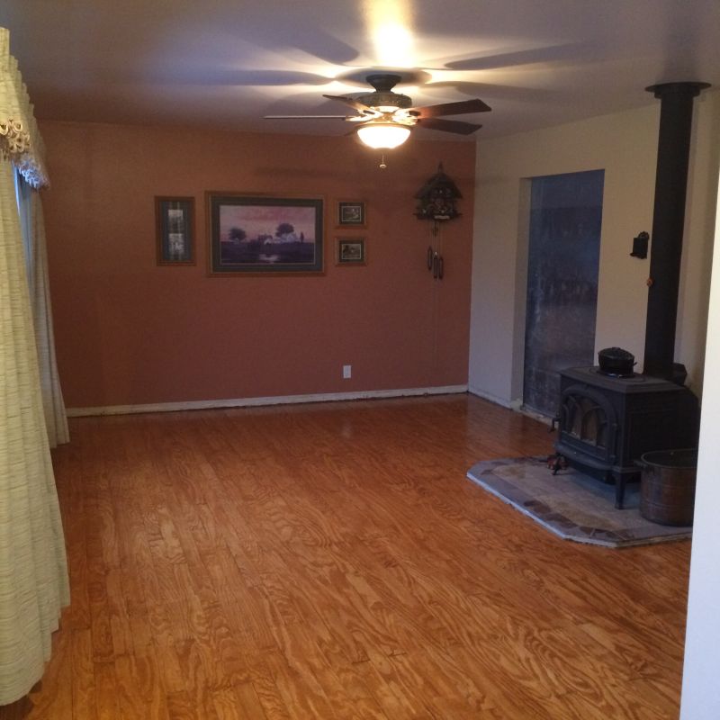

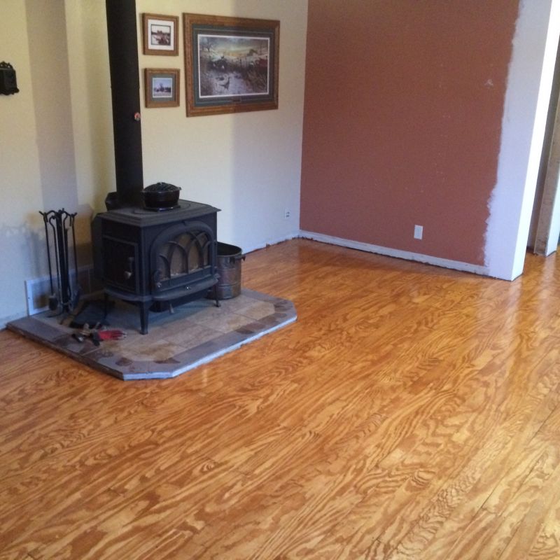

I made our living room floor of 3/4" BC sanded plywood. I stained them and used 3 coats of minwax water based floor finish, turned out ok but it was a lot of work.

very nice, are those full sheets or rips??

We ripped the 4'x8' sheets down to 3" strips. The floor turned out fine, but if I were to do it over I would have just installed 2 1/4" red oak. All the labor to make the flooring just was not worth the time. If you like wide plank flooring then it would be less labor to produce.

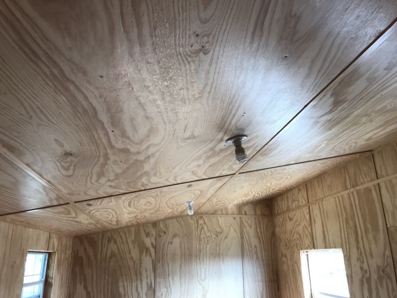

Well little update on operation latex clear coat. So after two coats on the walls and ceiling things are looking good. Probably do one more coat on the walls. As you can see it went one with a milky look but dried clear. I did use a semi gloss to get a little shine. Wish I would have sanded everything down a little first so it would have been smoother but it's not bad. Went one super easy just like painting drywall. Now it won't be a hard protective coat like a poly will but hopefully it doesn't get too bad of abuse.
