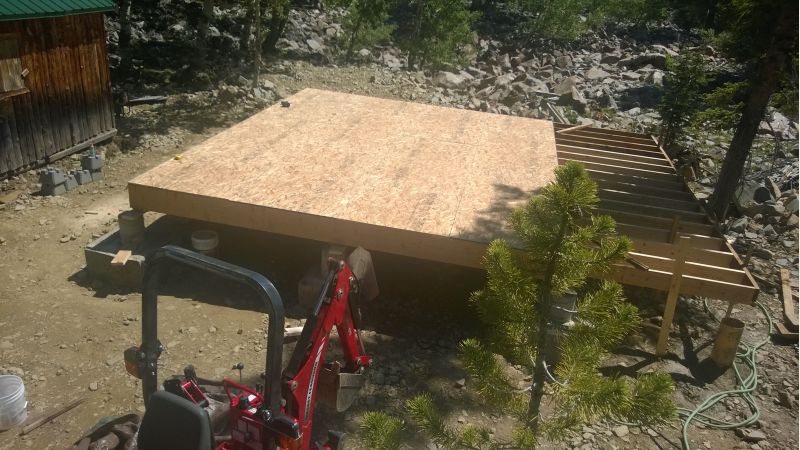

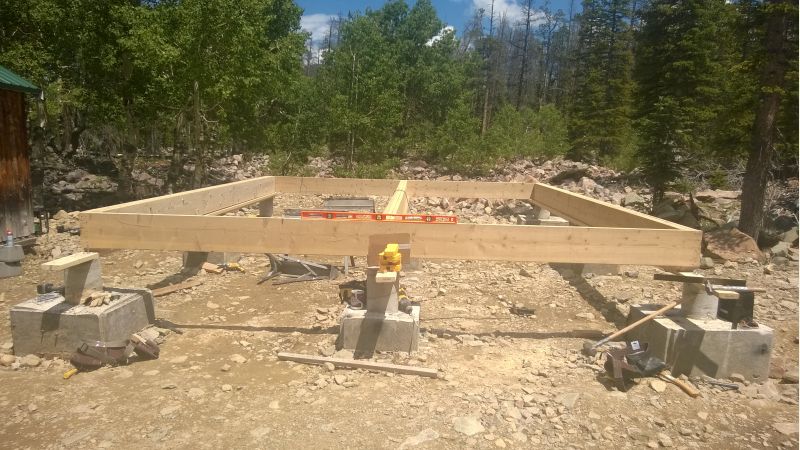

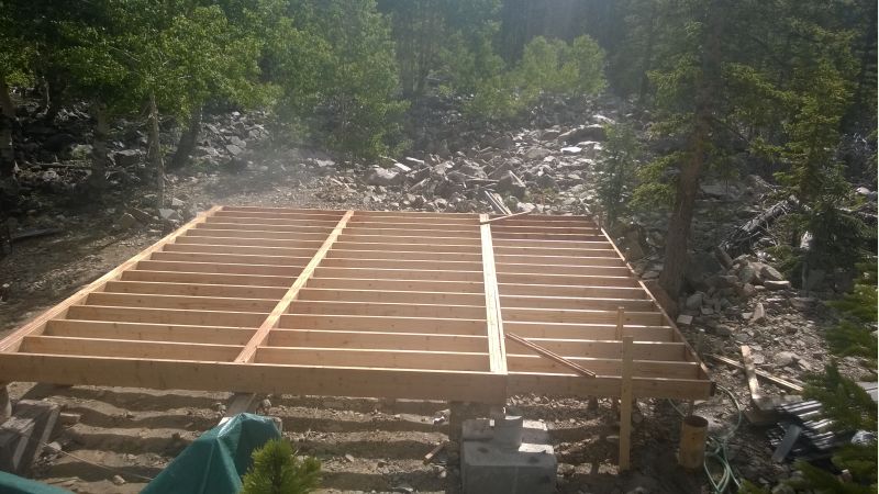

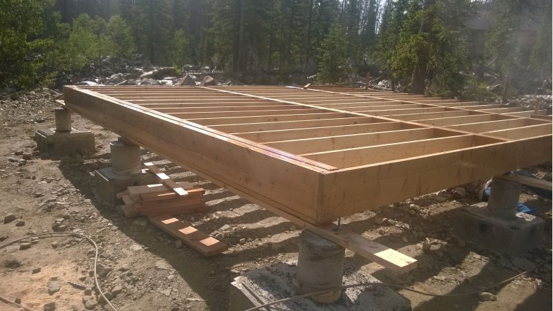

Here is how I did mine...

Quoting: Srollins
Thanks for the ideas all, I think instead of using 6x6 for the runners I will install a 2x6 sill plate from pier to pier then run double 2x12's on top of the sill plate, then transfer to standard framing material from that point. If my math is correct at that point bottom of floor joist at the low end should be at least 24" off the ground. I found the suggestion about the plywood subfloor interesting 50/50 mix of engine oil and diesel fuel? that is worth looking into and certainly cost affective just seems a little strange and if I apply that mixture would I skip using construction adhesive on the top of my joist? with an oil and fuel mixture the glue wouldn't stick right? any thoughts on using a bedliner type of spray or some type of paint applied to the underside of the plywood? Not sure why im so worried about the underside of the subfloor but it is open to the elements , with now using a taller 2x12 doubled up I could insulate the floor and use a soffit material ? just worried about the underside subfloor I don't want to replace it .
I use new engine oil (cheaper the better) and diesel, It leaves a clear finish that is the best thing I found, outside of chromated copper, to preserve wood. Bugs hate it and the water just beads right off...
Look how I did the floor beams, I used a 2x6 on the bottom to act as a sill plate and then the 4 2x12 on top. It was all designed by a structural engineer for the snow load in our area, which can be up to 10 feet at times.

# Posted: 12 Sep 2017 11:09am
Very nice, did you use glue for your subfloor plywood? any issues with the 50/50 mix causing the glue to not stick to the plywood?
snobdds
# Posted: 12 Sep 2017 11:17am
Sure did, we used gorilla glue, waterproof and a little goes a long way. We just let the oil soak in and dry for a week, then laid the sub floor. Just make sure you use tongue and groove sub floor and good galvanized spiral 8d wood screws. I hand drove the nails on the entire floor, as you can't get spiral nails through a nail gun. Those suckers will never pull out and keep the floor nice and solid.
