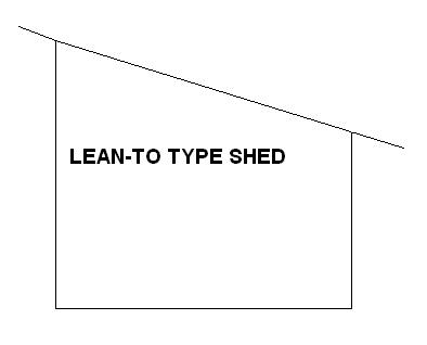

IMO, the most simple, and least expensive is the lean-To type of shed.
depending on your local sources, $800-$1200 should do it, but careful Craigslist and bargain shopping could make it do-able for a whole lot less
Built several of these (tool sheds-shops-shacks)
Have fun with this
Gary O'
Lean-To Type
Lean-To Type

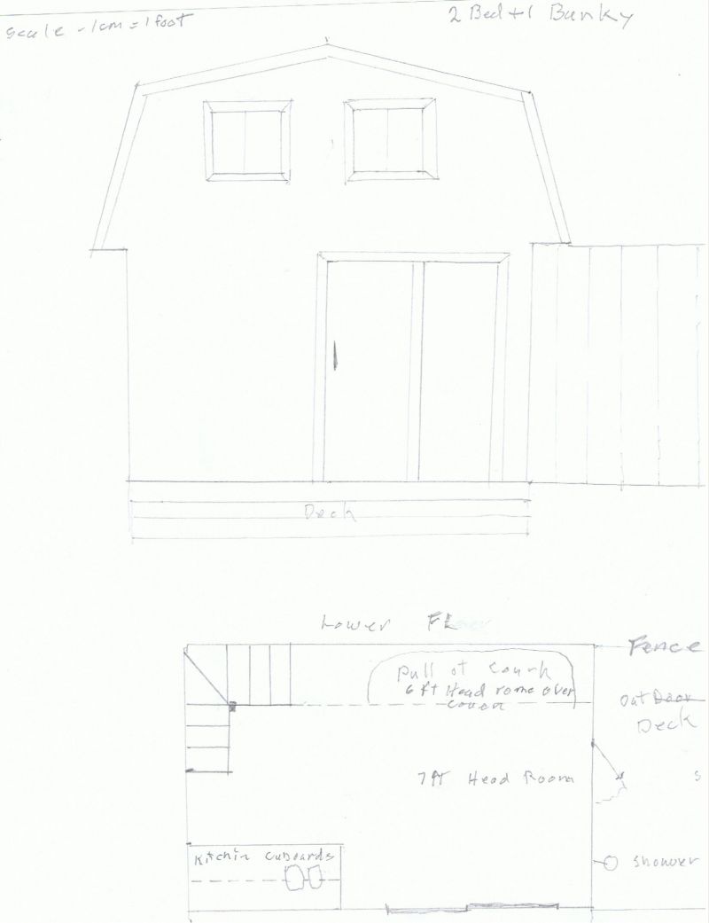

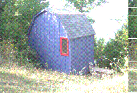

# Posted: 27 Jan 2011 10:27pm
BUILT THIS ONE IN 04 8 X 13.6 WITH LOFT .. 2 X 4 FRAME WITH SINGAL SKIN EXTERIOR PLY-WOOD , USED WINDOWS AND DOORS ... 2000$ I WILL TRY AND SEND PICS!!!
FRONT
FRONT

ONLY PLAN WE HAD
ONLY PLAN WE HAD

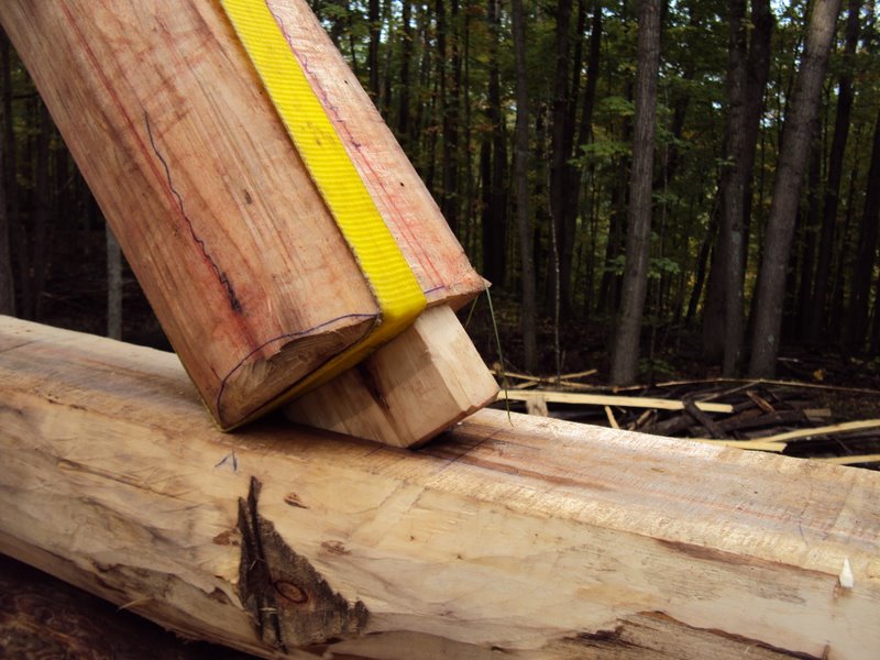

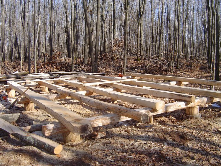

If you have trees, you can build the frame with mortise and tenon construction with your logs or beams without cost. Same goes for the sills and joists.
fpw
# Posted: 12 Feb 2011 01:19pm
This is what I mean by log work with mortise and tenon and making floor joists.
Mortise and Tenon
Mortise and Tenon
Joists from Logs
Joists from Logs
