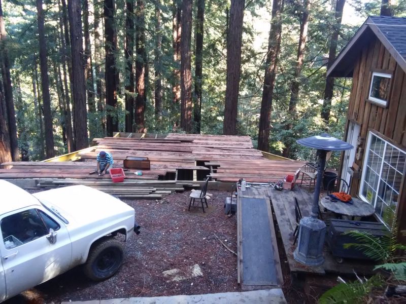

I have been milling redwood boards for a 500 sq. ft. deck for the last year off and on, and finally have about enough to start laying it down. My small bandsaw mill has a hard time with these large logs, and combined with operator error there is a variation in thicknesses, probably close to 1/4" from the thickest to the thinnest. I can get around much of this by matching adjacent boards but I'm thinking maybe when it's all laid out I could rent a sander, like used on hardwood floors, and run over the whole thing. Sound reasonable? I suppose i would have to do this before the screws go in. The alternative is to get them planed but they are too large for the average bench planer, I would have to load them all up and take them somewhere.

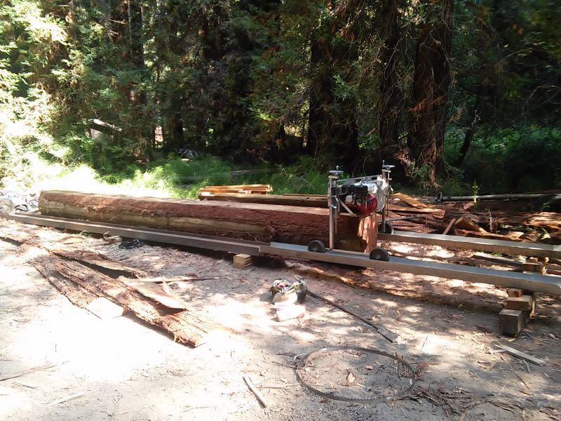

If you have a band mill of your own. I would put them on the mill , straighten them , rip them to a standard width, or several standard widths. They will now be easier to handle. You will likely be best to shorten some of those big long boards, as well, as I doubt they are perfectly straight. You can now lay them on the mill bed and dress a bit off the thick ones.
Or you can get yourself a 12 or 15 inch planer and plane them. If you have a mill, you will use it for lots of projects. Good Luck old 243

Thanks again guys. There should be about 15-20 rows of deck boards, so if I put the think ones at one side and work my way down there should be much less than 1/4" variance between adjacent boards. So the overall deck may be 1/4" thicker over the joists on one side but the amount needed to be removed to even out adjacent boards would be far less.
Just the same, I am going to look around at planers, as mentioned it would be nice to have. I'm sick of making boards right now but surely there will be more in the future. Loading and hauling all these boards to another location would be a lot of work but also a possibility.
Here's the mill I have. It's really suited to smaller logs, doing this big stuff leads to some of the variances.
