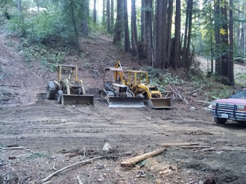

I just cut and bucked a huge tree into 20 ft. lengths yesterday. 3ft. at the base down to abut 2 eighty feet later. Lifted them onto my mill with my old backhoe. It would barely lift the big one, the others high enough for the mill but wouldn't get them on top of a wall. I did lift a 20' 12" log on top of my gate poles about 15 feet up. It's 50hp. One nice thing about it, in addition to the front loader, are the outriggers on the sides that keep it stable when moving things left to right. No experience with the mini-excavators, which also have their advantages. Street tread vs. tracks also to be considered.

That says a lot about the power of the good old backhoe/loader. What a tree! I agree about the utility of the outriggers. And that's exactly why the mini excavator is more mobile! I'm hoping to hear similar working experience from a mini excavator owner.
# Posted: 12 Oct 2017 05:39pm
The outriggers lift out of the way completely but yeah, compared to an excavator it's a barge.

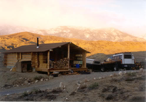

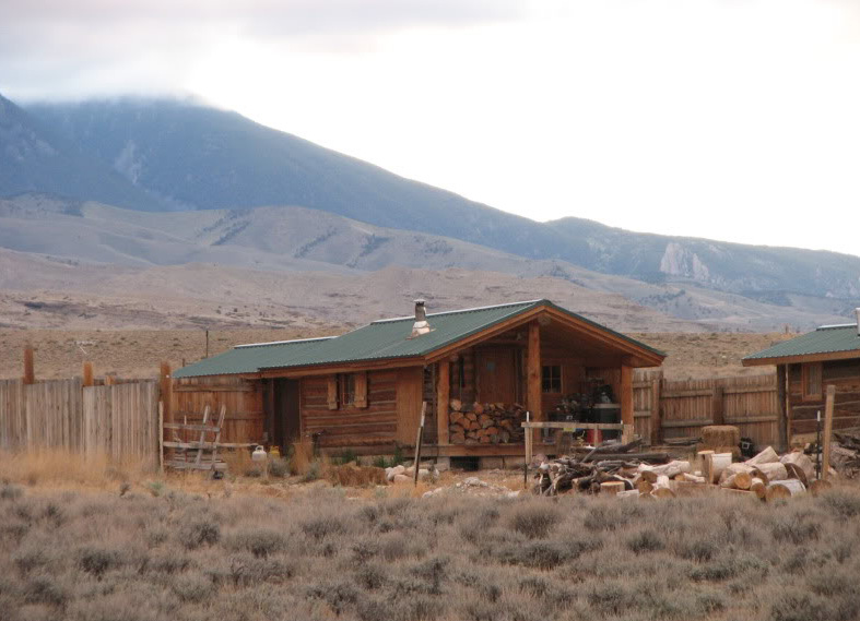

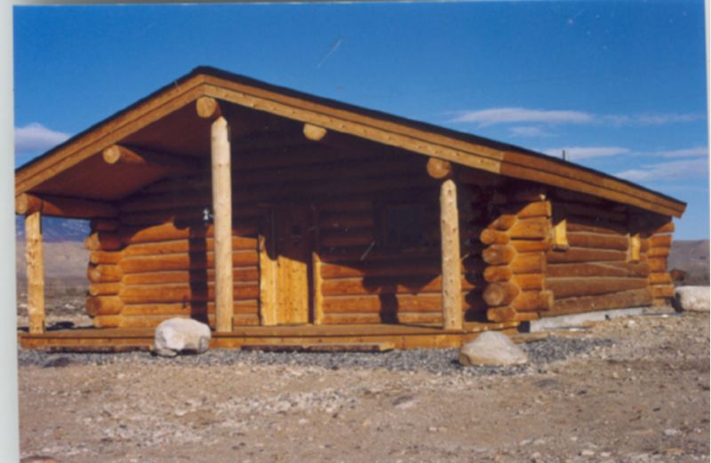

Malamute
# Posted: 19 Oct 2017 11:24pm
Hmm, one didnt load and cant be added now, so here it is.

Hey Malamute, those are beautiful as are their 'yards'! I love the porch columns which I'm guessing are not structural? The roof pitch seems shallow. Are you not in snow country?
Skoot, I'm curious how the cable is attached to the trees. And did you stretch guy lines to reinforce those the trees? And what kind of sling did you use?
Malamute
# Posted: 20 Oct 2017 10:09pm - Edited by: Malamute
Thanks, I love the country I'm in. Vast areas of public land, high mountains close by, all manner of game wandering about in the area. Its not as romantic or picturesque as forest, but then I dont have to worry about forest fires. Land there mainly buys you space from other people. It doesnt require a lot of land, but some buffer is nice.
I like the shallow pitch roofs, they are more traditional in the western mountains regardless of snow. The frontier cabins were mostly built with dirt or sod roofs. The low pitch roofs are also really easy to built and work on. Steel roofs do fine with any amount of snow, but we dont get a lot for the most part.
Yes, the porch posts are structural. The larger cabin has screw adjusters under them, but I dont recall ever adjusting them or the current owner saying anything about it. I ran 5/8" allthread down through the walls as far as i could drill, about 6 feet. I left gaps to tighten them after a year or so, I think they took about 1/2" of tightening. My logs were dry, dead standing, had dried more sitting in the lumber mills yard before I bought them, dried more on my site all season as I built it. I left gaps above all the doors and windows also, they never settled much, despite dire warnings from many sources. The doors and windows are splined to allow settling (2x4 inletted edgewise into the log ends, the door and window frames attached to the splines). I used the foam pipe insulation as filler/backer above the doors and windows, then chinked over them. You can see the settling, it bulges the somewhat, it just didnt do it a lot. On the smaller cabins, I just frontiered it, nailed directly through the frames into the logs, No problems at all. They were also very dry logs.
