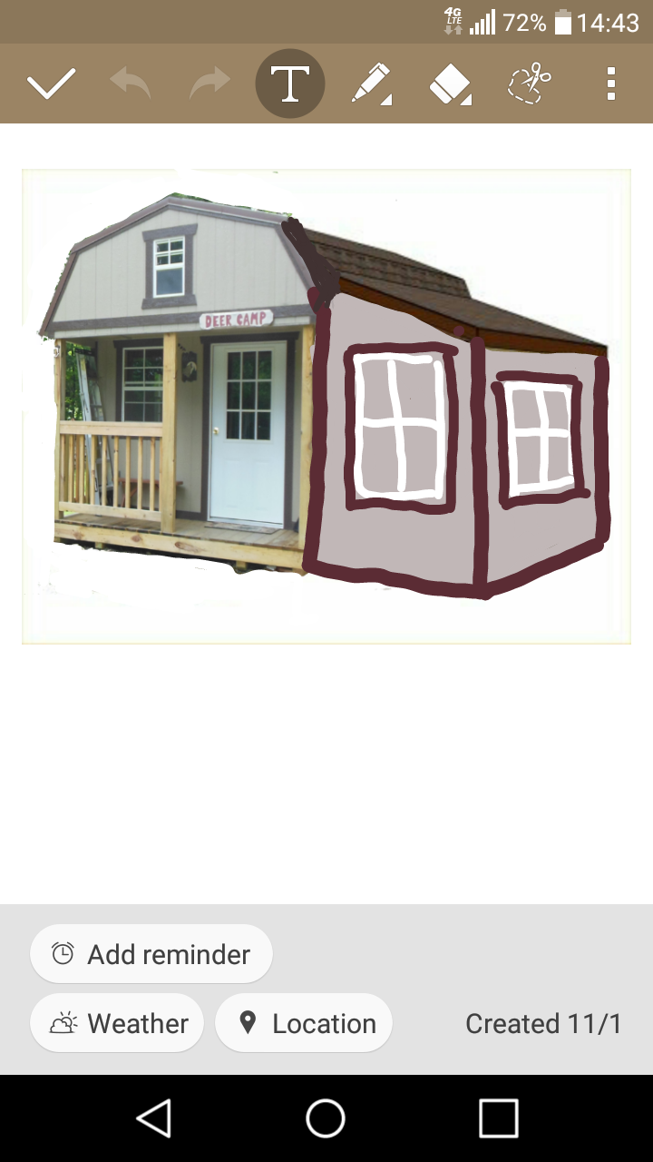

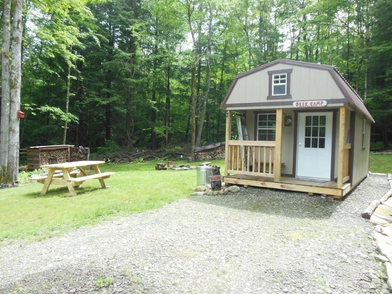

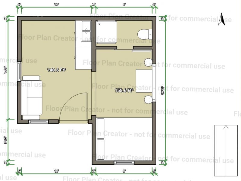

Hello. I'm looking for tips on addition to prefab cabin/shed with gambrel roof. Family is getting bigger and kids love being in the woods so here we go... I post some pictures how I want to do it and look for some input from experienced members here. The cabin is on skids and will be moved to a different spot soon. It is 10x20 (4 ft porch included). I want to add an addition on the side of it extending another 8 feet and 20 feet long. Did anyone here did anything like this? Is this the right concept? What do you think?
The pictures show a cabin a floor plan and a sketch of the addition. Sorry I did it quick on the phone.

I can't comment on the addition, but when we needed more room for the kids we chose building a bunkhouse instead. More privacy. Also then you can have guests up and they can have their own little place.

have you considered a dogtrot style addition, maybe a hallway into another separate structure that could also be separated and moved easily.

I thought about it but I have a small wood stove and in the winter the heat distribution I'm afraid wont be that good. Just this weekend it supposed to be there in high 10's.

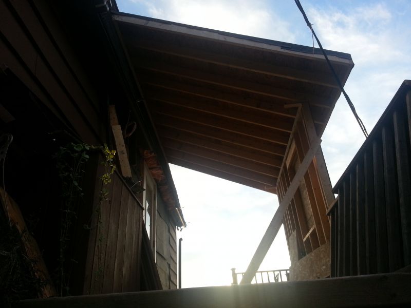

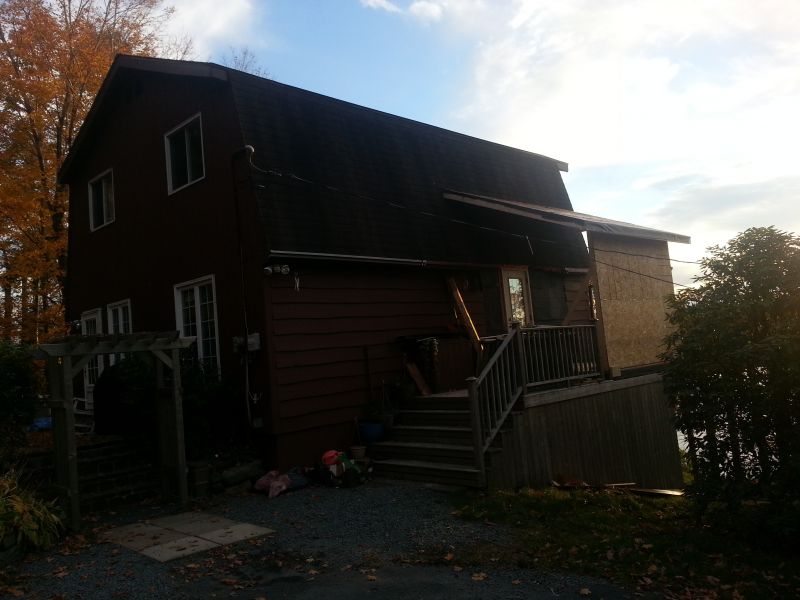

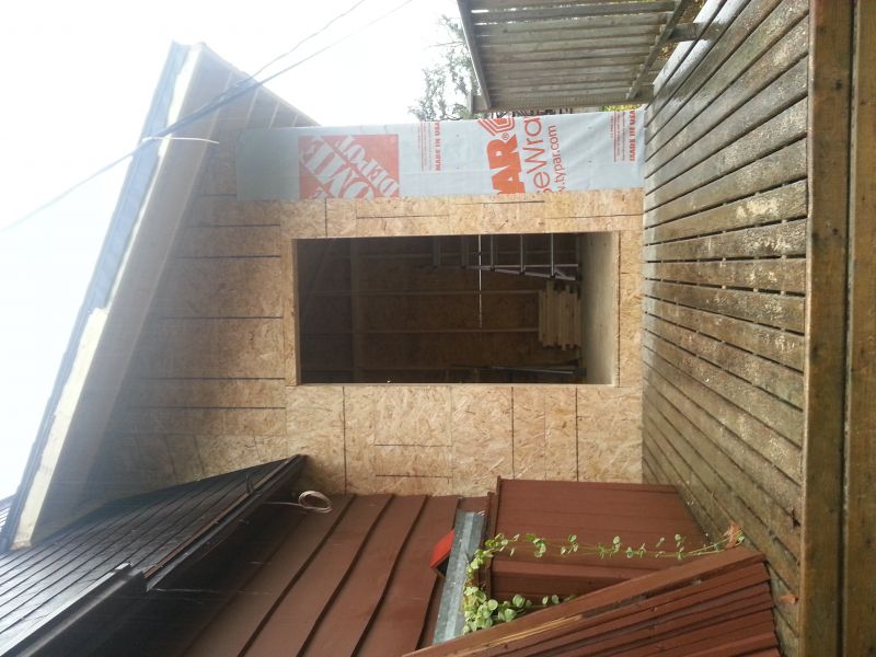

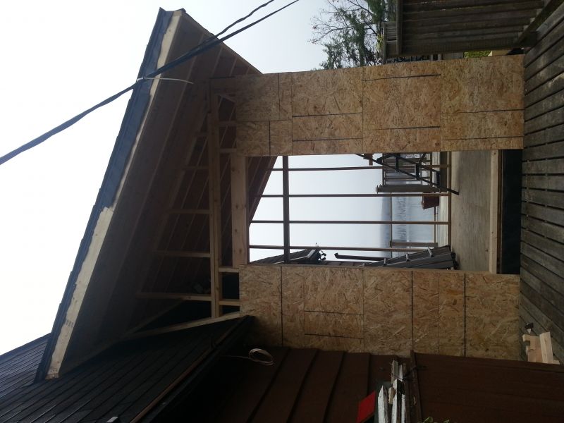

Did almost exactly what you're thinking of on my house.... house is 24x32 extension is 8x10 with a 3 foot over hang in the front, 1 foot in the back.

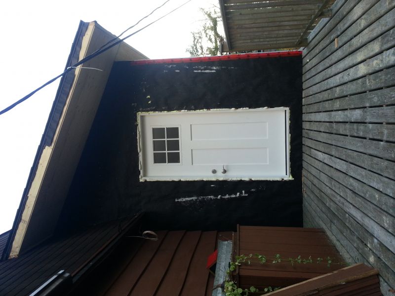

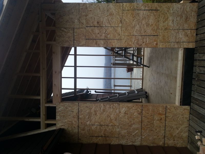

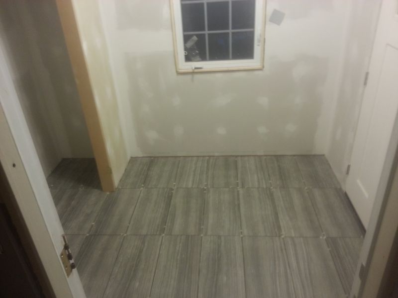

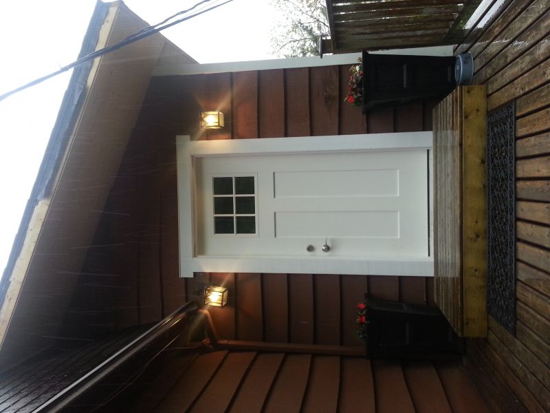

A few more...
Inside
Inside
Finished
Finished
