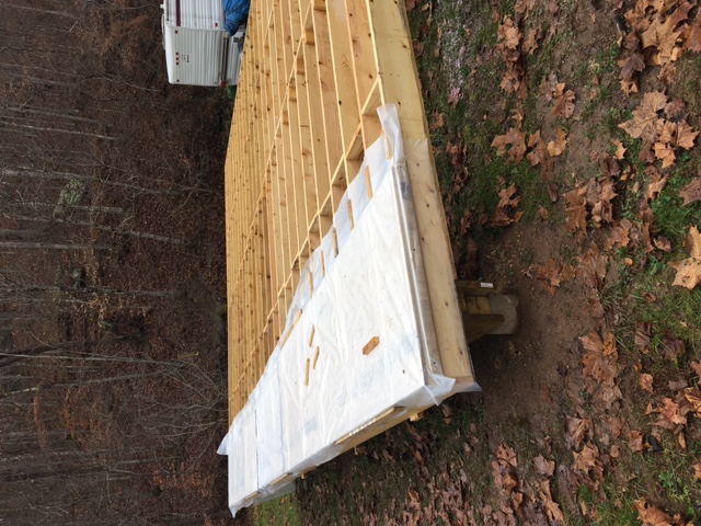

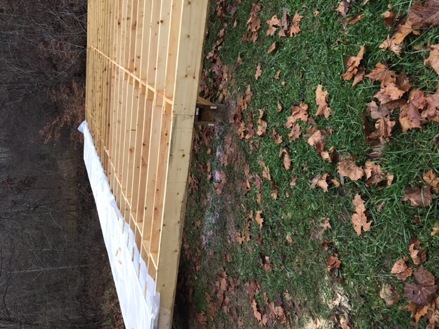

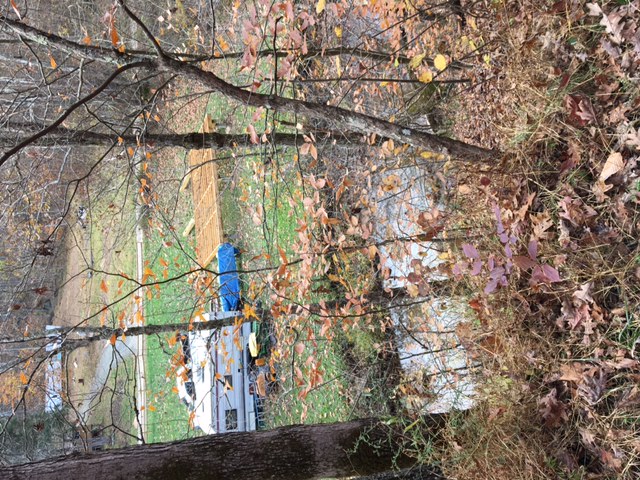

# Posted: 25 Nov 2017 07:26am
Here's some pics of my cabin project in West Virginia.

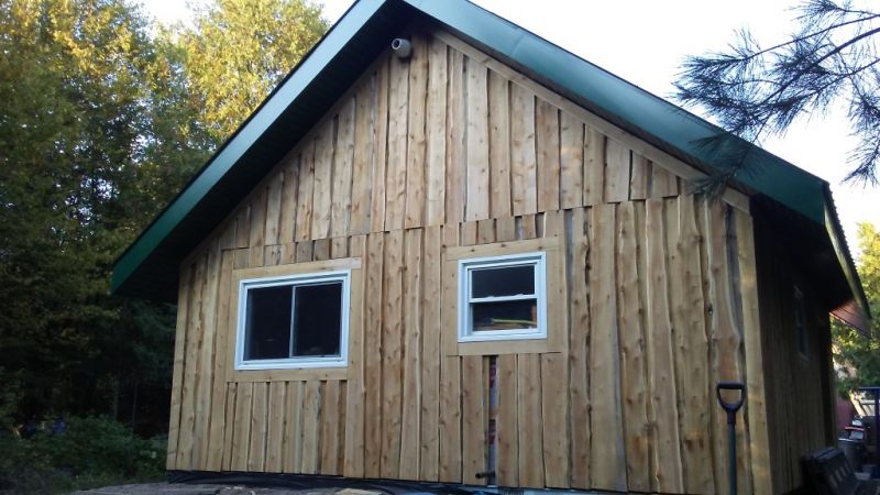

# Posted: 25 Nov 2017 07:49am - Edited by: Steve_S
Rockies makes very good points there.
Because of how I built my place and materials I chose, my exterior walls have 5-1/2" of EPS-II foam between the wall studs & with cathedral ceilings 7-1/2" of PolyISO between my rafters, I did not want to put holes in any of it (doors, windows, exhaust vents & air intake excepted of course LOL). So I have run my electrical within the few internal walls or on interior surface where needed (2 spots), my plumbing same thing, water pipe comes in through the concrete pad from underground. The kitchen sink, shower and washroom sink drain lines are also surface run at floor level (shower is on a platform of sorts) and 1/4" per foot slope observed for those. Everything is hidden from view with the exception of the cleanouts

** Below is my West Wall showing the Live Edge, BR & Bath windows and the HRV end sticking out at the top. Notice how deep the facia is ? That's just under 12" because of the Cool Roof design which keeps heat out in summer and warmth in in winter and no thermal transfer.
West Wall BR & Bath window, HRV Vent at top.
