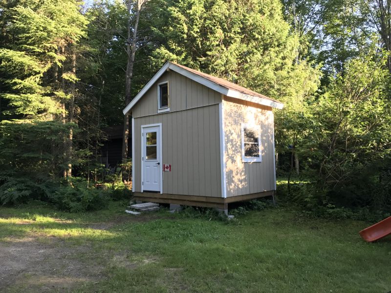

I have a camp near Timmins Ontario. Been there 35years. Ground is clay with large boulders. My experience and advice to you is to clear topsoil, including all roots. Put down crushed rock and pack it making sure you are above grade. Get any drainage water to run away from each the cabin area. Put down cottage pads with concrete blocks on them. Put on your beams and build. You are going to have some frost movement."Do not try to level or shim until frost is out of ground". If you do you will be wasting your time. Good luck.

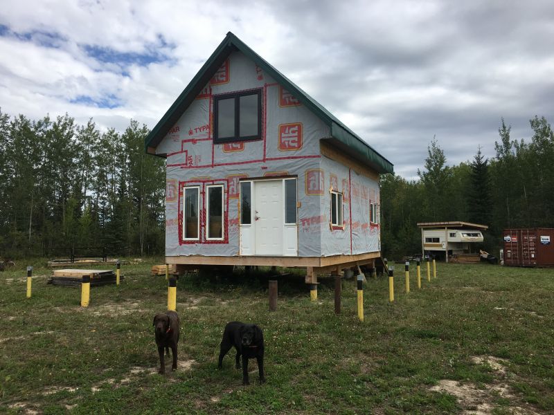

My place is on clay. I bought a bunch of 10' 6" pipe at an auction and pounded them in until they stopped. Took me all weekend with a friends post pounder. You know, the ones for pounding fence posts. I did have to pre-drill with an auger for the first couple of feet so they would fit under the ram. They all went down about 8-9'. It's been almost 3 years and I haven't experienced any disernaful movement.
Greenland South
# Posted: 11 Feb 2018 11:11pm
The smaller diameter posts in the picture are for the deck in case you're wondering.

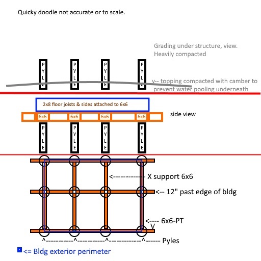

The load ratings etc are located on the Pylex Site and for the 66 they are pretty heavy duty. These are commonly seen on those temp barns with the canvas tops & hard sides (usually wood). See photo below as an example, and you can imagine the pull when winds get up under these, so the pyles are designed with that in mind.
IF you want to build with these you certainly could do it but appreciate the caveats for doing so. * not intended to last forever, maybe 25 yrs +/-. * Resale values, property values would be lower (temp building).
IF your still interested then I would think of 3 primary 6x6 runs with 6x6 cross, then a 2x8 floor joists and perimeter framing & build on top of that. See quicky doodle I just whipped up below. Note the compacted sub base of gravel that has a camber to prevent water from collecting underneath the structure. 6x6 overhang allows to attach porch etc & if ever needs to be moved, this will help. Wrap around deck / porch very highly suggested !
I would try to leave a minimum of 18" better 24" from grade to 6x6 so you can get access underneath when it's needed and if any water issues arise it will stay drier longer... not having enough space & air movement underneath invites mould, mildew & eventually rot, all of which is best avoided.
You do not want organics under your building, so it is really best to remove topsoil and fill + pack with a neutral thing like gravel and to make sure that water / dampness cannot affect from below... also prevents bugs & some critters.
NB> The whole clay being so close to surface makes me think your in a potential floodable spot... be very aware of water levels reached and potential for flooding. If you are on a floodplain, even if rarely floods, that really needs seriously better thinking and more planning. Look at how many folks get flooded out and the insurance etc is getting harder to get and crazy expensive too and even the Gov't won't help ya out much and that will not be getting any better in the future.
My quicky doodle.

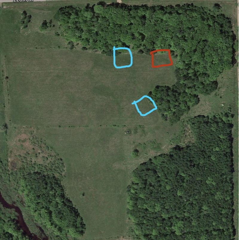

So, this is my out. We've bought 40 acres of land near where I grew up. While I'm serving out my time in management, we're going to start a farm and work on getting to that simple life we both want.
Anyway. That's where the cabin comes in. I've attached an image of the land. The spaces we're building are high; and one of them is half hill, so it would allow for water drainage pretty well. The blue spots are possible cabin locations, the red is where the house will be built. The southern (bottom) portion is the wet zone. We're going to build a pond down there to collect the water from the land.
I really appreciate the input. I've seen a smaller Pylex available on Amazon (Link to Amazon) It has the same weight bearing as the 66, but I imagine the lateral strength is less. Would this be usable for my purposes?
Thank you again. Land; blue for cabin, red for house.
