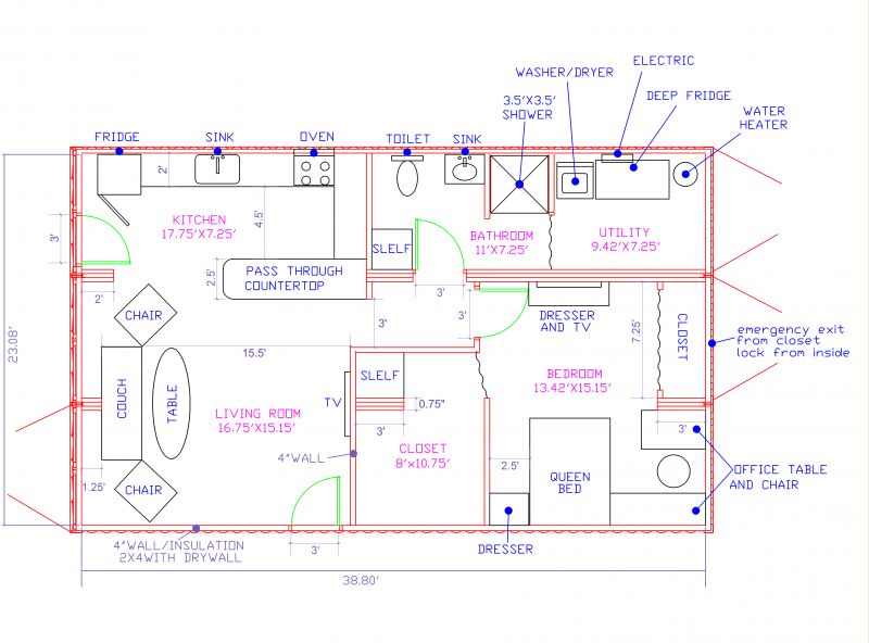

I designed this conex home for me to build in N. Florida in the furture it will be a 1 bedroom using 3 conexs 40' long.
Since I have to idea how to build one of these does anything look obviously wrong. I will be staying in the house during strong storms maybe even hurricanes so I'm a little worried about cutting to much metal walls out.

It would be helpful to show us exactly what a "Conex" looks like.
Your layout plan looks pretty good. Where do you plan on eating? If you're only going to be eating at the pass through countertop bear in mind that your stools will protrude into your hallway. I would scrap the pass through counter and use a small round table with 2 chairs for eating and have extra folding chairs available for guests. If you used a sectional sofa in the lower left living room corner you'll have enough room for the table and chairs. Change the kitchen door to an outswing so it doesn't interfere with the fridge door. As to the side kitchen countertop you may want to consider including a tall pantry cabinet next to the hallway opening (keep the countertop between that and the stove and put open shelves above the counter.
I think your big closet is too big. Divide the closet in half vertically and give yourself a coat closet by the living room door and make the other side the bedroom closet The wall that the TV is on should also align with the kitchen wall opposite.
Get rid of the smaller closet in the bedroom and put in a smaller 2'x2' linen closet and turn the desk sideways to run along the right bedroom wall.
All in all, it's pretty good.

Conex are the big metal shipping containers 8' W x 40' L. You can google "Conex shipping container" for pictures.
Thanks for the ideas.

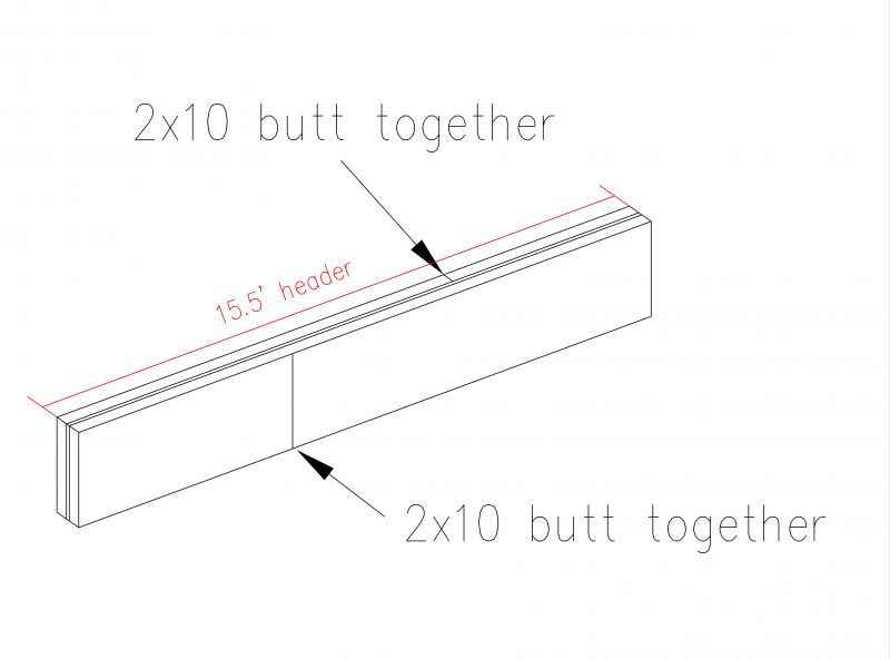

I was concerned with cutting out 15.5' of the steel walls, could I put a 15.5 header in? Do you have to use a whole pieces of wood for the header or could I use 4 - 2x10 cut them so I don't overlap the joints (sketch attached)?

" A whole peice of wood " yes no cuts ..

Where do you take off muddy footwear and wet clothing when you come home in a rainstorm? How far do you have to walk through the house to put away coats and shoes? Where do all the sheets, towels, cleaning supplies go?
In considering your plan it is quite good to begin with, but you'll make it far more functional if you divide that large closet down the middle into a closet for the front door, a bedroom closet and I would also consider adding a third small closet facing into the hallway right behind the TV. That could be your broom closet.
