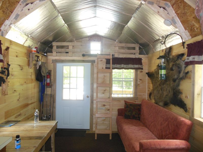

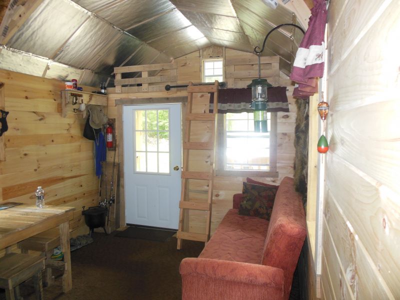

I had the same problem like you. I have 2x4 rafters 24'' OC and first I insulated my roof with pink insulation. At the time ACE hardware was carrying 23'' wide insulation. The problem was that the roof was not vented and I had problem with condensation under that insulation. I have the same roof, metal, tar paper and OSB. What I did is I cut a ridge vent and drilled holes in the soffit, the I nailed 2x2 pieces to each rafter (1.5x1.5) and then I used a ridgid foam board from Home Depot, it is 2'' thick and rated R-13. I cut those boards to fit between the rafters very tight and than taped it with aluminum tape. That gave me 1.5'' air space between my insulation and roof sheeting and proper venting takes care of the rest.
xtolekbananx
# Posted: 19 Feb 2018 12:17pm
here are a few photos
xtolekbananx
# Posted: 19 Feb 2018 12:24pm
and finished
