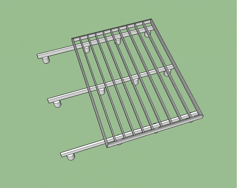

Can anyone comment on the layout of this frame, foundation and the girder size?
It's a 14x20 cabin. Loft on one side. My plan was to use PT girders. Where they are extending out is to support a porch.
The 3 rows are spaced 8'10" apart. The spacing of the piers under the cabin on each girder are 5 and a half feet apart.
My plan was to use 2x8s for the joists. Not sure what the girders require or how this spacing and layout looks.
Edit: A little more info. This is temperate climate. No frost. No snow. The soil isn't great. Clay on top of sandstone mostly. I was intending to do sonotube, but I was also considering using larger precast footings (24" wide) that would sit mostly above grade. Thoughts on any of that?

This may help: http://www.awc.org/codes-standards/calculators-software/spancalc
That span calculator should help you with the sizes. I don't see any concerns with the spacing. While the 2x8 will easily cover this distance, you may want to go with 2x10's since they are only about $1.50 more per board (at least at the 8' mark). This would add extra strength and less vibration for minimal cost. Again, the 2x8's should be fine, just a thought.
As for the girders, what size are you thinking? Have you considered using build your own LVL? 2x10 or 2x12 and sandwich 1/2 plywood with waterproof adhesive (and nails to hold it all together) in between to get a 5.5 width beam. You can get some triple plated post connectors to attach it all together. Those would be plenty strong.
While you mention no snow or frost, I'm assuming you do get rain. If that is the case, you will want all of what you are proposing to be pressure treated wood. I have ready anything less than 18" off the ground you want to be pressure treated as the ground will give off water vapor under your cabin. You don't want rot/mold.
If your soil is relatively soft, you will want as much surface area to spread the load as possible. If you do go with sonotube, you may want to go fairly large vs the smaller 6 or 8" sizes.
Again, YMMV, my personal mantra is, "anything worth engineering is worth over engineering" assuming the cost doesn't change significantly.

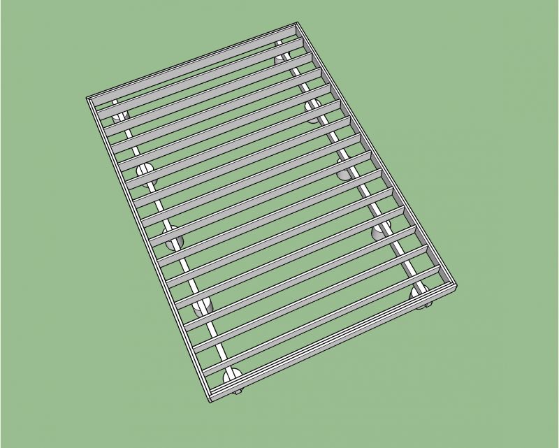

# Posted: 25 Feb 2018 09:59pm
Here's a revised drawing. 14x20' cabin.
4x8 pressure treated girders on 12" sonotube footings spaced 55" apart. The frame is 2x10s, doubled up on the perimeter. Non pressure treated, but it'll be over 18" above grade.
Joists are spaced 16", overhanging the girders by a foot.
Thoughts?

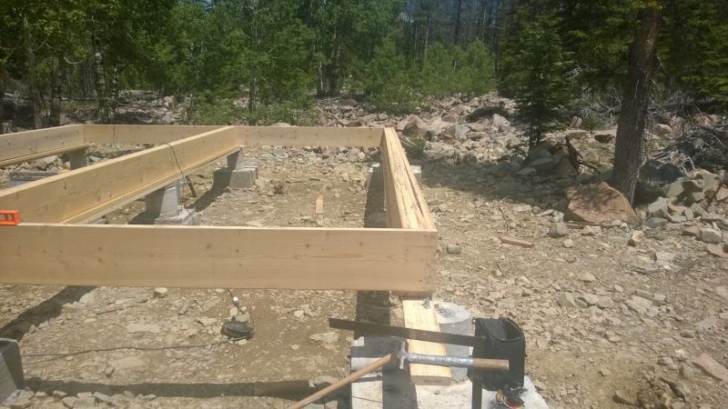

# Posted: 26 Feb 2018 11:00am
Quoting: caducus
On that 2x12 frame, you're not resting that on any girders I take it?
No girders. All the floor joist are hung off the side and middle beams by joist hangers. I love modern mechanical fasteners and use them everywhere. Joist hangers are great because you will never get any lateral or compression movements. Plus with "TECO" nails holding everything together, it resists wind uplift coming from under the floor, since I am 3 feet off the ground.
Plus I wand my load bearing walls on the outside of the beams, nothing on the cantilevered portion of the floor.

# Posted: 26 Feb 2018 11:02am
I understand not wanting to cantilever a wall. Though 1' on 2x10s with a doubled up rim joist seems adequate to me. I'd worry that in pushing out to the edged with the girders I'm getting up to a joist span that's a little spongy.
The other consideration is that the ridge I'm building on has much better soil the closer you get to the center line. Keeping the footings at that width feels a lot more stable than pushing them out to the full 14'. Not that I'd worry they'd fail being an extra foot out, but long term it would give me a lot of peace of mind.
caducus
# Posted: 26 Feb 2018 11:07am
I just read this regarding load bearing walls and cantilevers:
"So how far can you cantilever joists and put a bearing wall on the end of the cantilever without engineering the joists? Loads transfer at a 45-degree angle through whatever is supporting them. Therefore, if 2x10 joists, which are actually 9 1/4 inches deep, support a bearing wall 9 1/4 inches from the support underneath, the loads will transfer at a 45-degree angle back to that support, and no engineering is required. So the answer is the depth of the joist from the support. Cantilevers beyond this distance need to be engineered."
So maybe there's a compromise there. 9 inches of overhang.
caducus
# Posted: 26 Feb 2018 11:17am - Edited by: caducus
9 inches of overhang gives me 11'11" joist spans with the 2x10s. That works for a floor. What about the load bearing walls on the front and rear rim joists? Between the wall, glass windows, a heavy glass door, that's a lot of weight. I'm having a hard time finding load tables that take into account the load bearing wall weight on a rim joist. It would be doubled (tripled?) but I just want to be sure that 2x10 with a nearly 12 foot span is sufficient to carry a wall of the cabin.

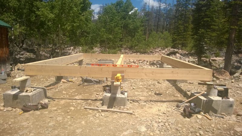

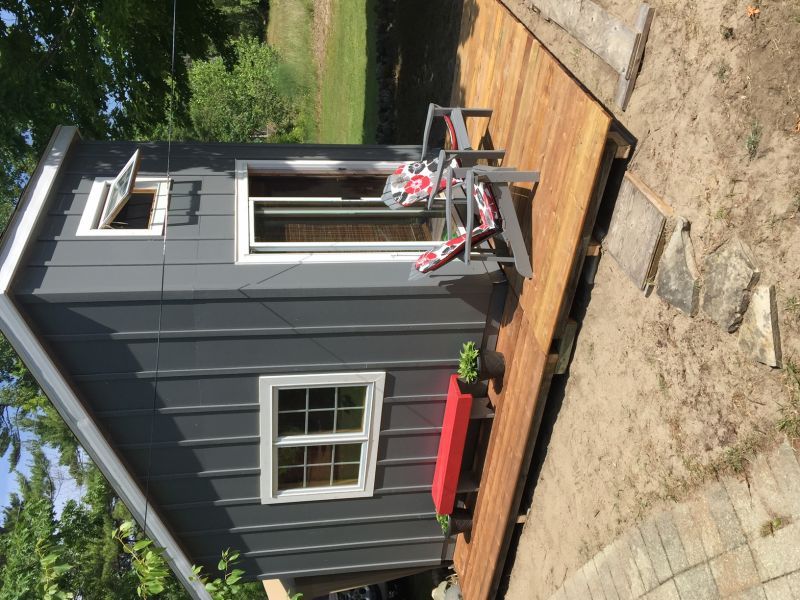

# Posted: 26 Feb 2018 12:12pm
As far as I know a 2x10 is good for a 14 feet floor joist . As long as you put the girter under that support wall there will be know worries .
In this pic of our bunky the door is supported by a double rim joist it’s been there 6 years still works well .
Bunky
Bunky
