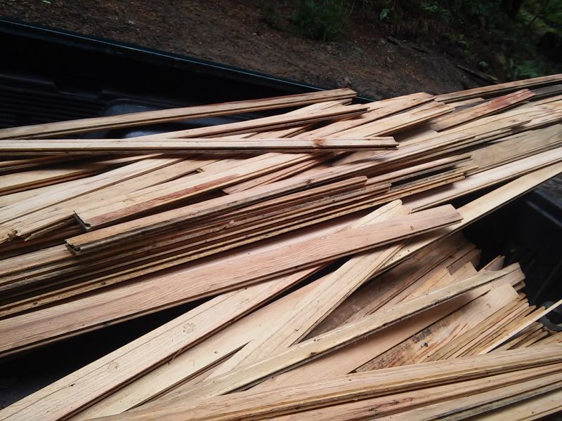

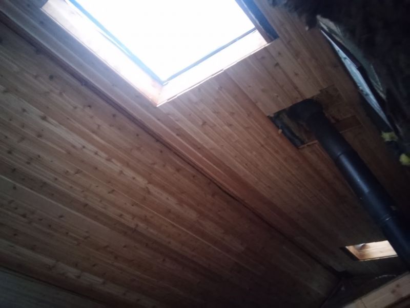

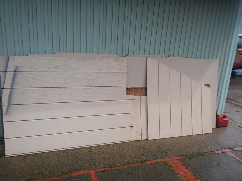

I'm also in the process of finishing my cabin interior, and I try to use leftover or recycled wood. I have the ceiling roughed in with 6" cedar T and G and have about 150sf left over. Then I picked up another 150sf of 3" cedar T and G, and just yesterday another 150ft of 2" oak flooring that's been planed. Non of it is enough to do all my walls, but I guess with all 3 there is enough, either separate woods on each wall or wainscot of some sort. Oh, and also, they are doing a bunch of work on a condo complex down the street from my house where I walk my dog, and every day they give me leftover T111, That's ongoing, might end up with a bunch of that.
One thing for sure, I'll be glad to get something up there and quit staking and storing wood! 0306181635.jpg

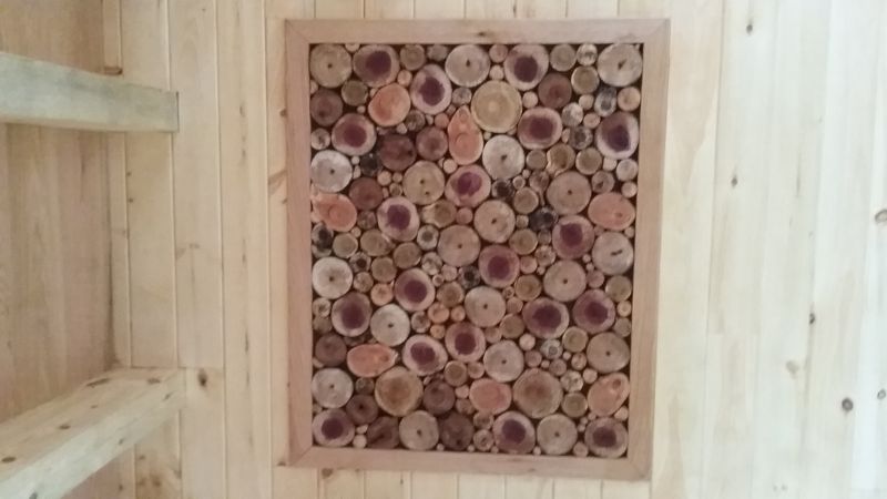

not sure how big a space your talking about but I did this on part of my one wall.

KinAlberta I like that. I may have a winner. I also heard you all on the rough wood aspect. One thing I have a huge abundance of if flat stone that quite attractive. I have a stream and three creeks running through my property and it's loaded with stone. I would likely do a wall area with that to make for a focal point but I also do like the idea Shadyacres has. I like the idea of incorporating materials from my land into my cabin. Every third building out my way is an Amish saw mill. I still might harvest some wood and use it. Thank for the ideas all
