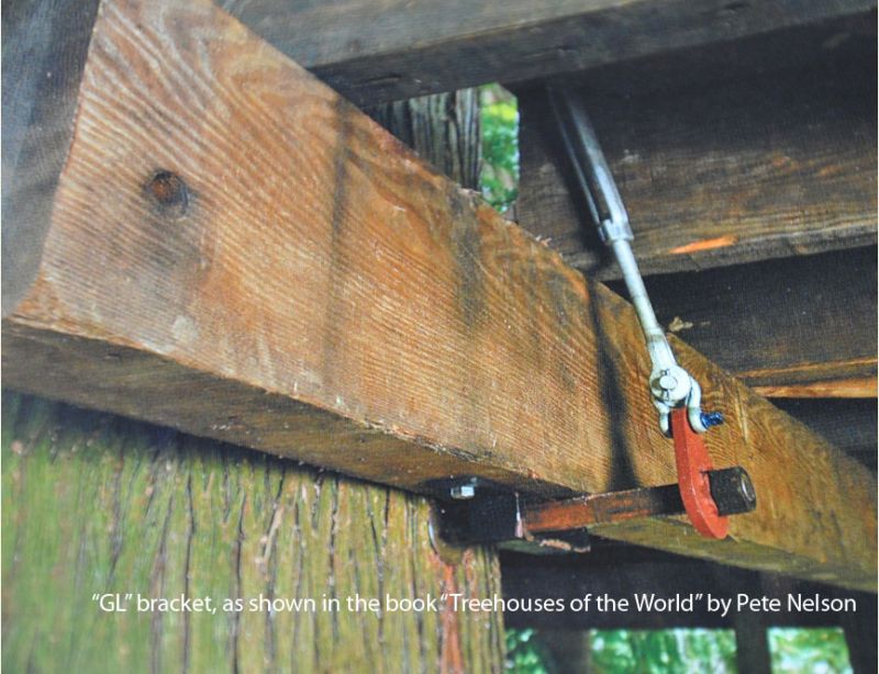

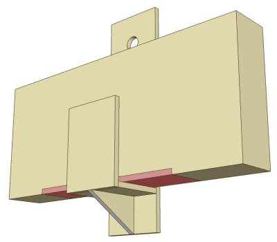

I bought a great book called "Treehouses of the World" by Pete Nelson. These folks build Treehouses all over the world, and this is the method that they have arrived at. I like this method, it's easily buildable, and makes perfect sense.
It was designed by a guy named Michael Garnier. Pete Nelson has a business called "Treehouse Workshop". You can buy them here. [url=http://www.treehouseworkshop.com/store.html[/url] And there's lots of other books about treehouses too.
I suppose some joints could be quieted, if you have a way to grease them.

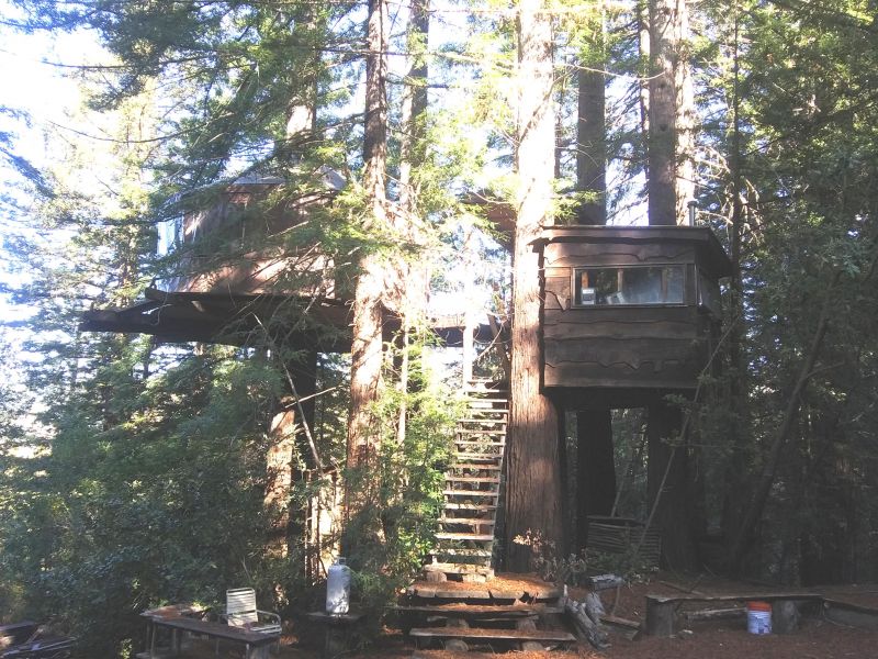

Took a hike up the hill behind my cabin the other day, onto the neighbors expansive property that surrounds mine on two sides. They had a guy working for them up until a few years ago, an Alaskan native with real back woods experience, we became good friends.
He's moved on but left behind his living quarters, a yurt up in a tree. It's on the left in the photo, hard to see detail. The other shack on the right was just storage.

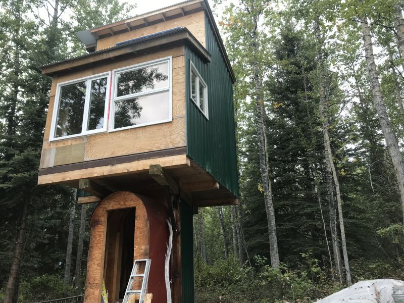

We are working on a treehouse type project.
Because we do not have enough trees of size and did not want a structure that we need to resupport in the future we used 4 power poles as tree. The structure is 16'x16' and 2 floors.
We enclosed the bottom for stair access and wood stove installation.

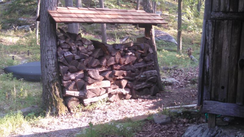

My "wood shed" is a roof spanning between two trees. The frame is lag bolted to the tree at one end, and rests on two short pieces of 2x4 bolted to the tree at the other end so it's free to slide. It creaks when the wind blows but it's become a comforting sound. At one point I rubbed some wax (old candles) on the sliding surfaces but I really can't say it made much difference.
