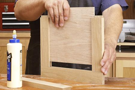

From what I gather from your description, you are building a gable end wall that will have a number of 1" thick glass panes set into a rustic owner-built frame of 6x6 logs and you are concerned that the shrinking of the logs over time might put stress on the glass and crack it later on.
I would set the glass within each "square frame" of logs. Router a channel in all four sides of each square (where the glass panes will sit) and place a couple of small wedges in the bottom groove to hold the glass up off the wood a bit.
As an example, if the glass panes are 3' x 3' you would router 4 grooves around the inside frame to fit in a piece of glass that was 3'1" wide by 3' 2" high. The extra inches will allow for an expansion space on each side of the glass of about 1/2" and a 1 1/2" expansion space at the top (above the pane).
Of course, you will have to install each piece of glass as you build the frame from the floor up since they will be "sealed" within the frame. The best example of this method is how they put panels into cabinet door frames.
