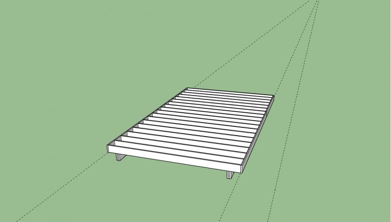

Hello,
Great forum! I am planning on building a cabin starting end of May and could really use some help planning my build - only thing I have built in my life is outhouse and woodshed...
Building in Wisconsin. 14x24 cabin with shed roof. I plan to build on two skids, each 1' in from the sides (12' span), and was thinking of using(3) 2x10's per skid.
Then planning on using 2x10's for floor joists 16"OC and using 3/4" T&G for subfloor. Does that seem correct? Hopefully...
I want to do some sort of insulation in the floor when building, but I am not sure what style to do. Ease of installation and getting a good seal is more important than saving money for me...
At this point, I was considering installing 2x2 pieces of wood 4" from top of joists (before I put joists together) and then putting in 2" foam board, using Great Stuff to spray seams, and then dropping in another piece of 2" foam. Is that a good idea? Do I need to worry about critter protection with this? Would I get almost as good with just 2" foam?
Do I need a vapor barrier if using 3/4" T&G as subfloor?
Thanks for all help and ideas!

Hmm. I was reading an article on the Green Building Advisor website and one of their building experts recommended filling the bay with mineral wool insulation to within 2 inches of the top of the joist (leaving an air gap under the subfloor). he said that by leaving the gap you get a warmer floor than from stuffing the joist bay full right to the top.
A better method than installing rigid foam panels inside the joist bays is to cover the underside of the EXTERIOR sheathing with roxul comfortboard mineral wool panels. These still allow the floor assembly to breath but by adding insulation to the exterior of the floor assembly it raises the temp of the exterior sheathing so that you don't get moisture condensing inside the joist bay. You'll have to cover the exterior mineral wool panels with something so insects or rodents don't get into it..
I would probably add a vapor permeable membrain underneath the subfloor sheathing. Poly is not vapor permeable and could trap moisture inside the floor assembly.
https://www.rockwool.com/products/comfortboard-80/
https://www.certainteed.com/building-insulation/products/membrain/

The comfortboard sounds great. In the interest of protecting the insulation from insects and animals (but, also allowing the space to breath), do you think 1/4" cement board would work?

Yes, I plan on using cement board panels attached to furring strips attached to the surface of the confortboard. The nice thing about both materials is that they are basically fireproof, so any wildfire that may run under the cabin shouldn't cause any damage.
As to fire protecting your under-floor beams, I would coat the beams with Flamestop 2. It isn't noticeable as a coating but it really helps prevent timbers (and exterior wood siding) from catching fire.
