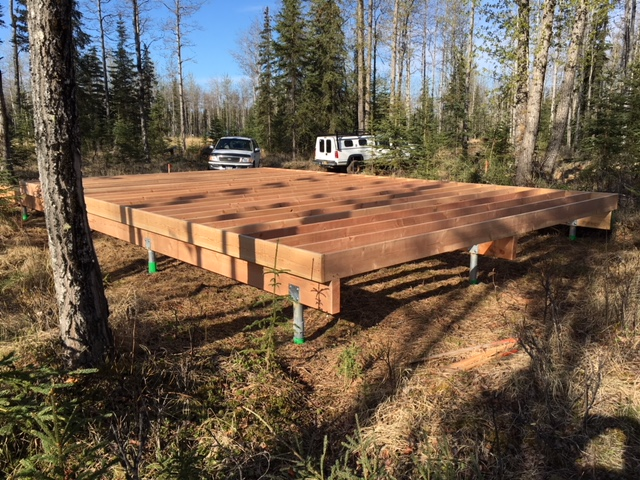

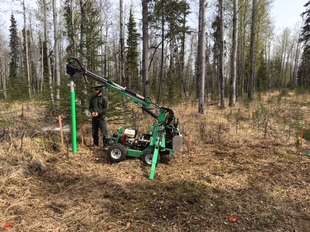

I used these helical posts with Teflon sleeves to allow ground heave to slide up the galvanized pipes. I couldn't be happier with the install and results, this was on the Kenai Peninsula, AK. They might be available in your area and they can get the machine anywhere a boat or helicopter can get to.
I couldn't find anything that was close to the cost to get the job done, they weld on extensions as needed.
