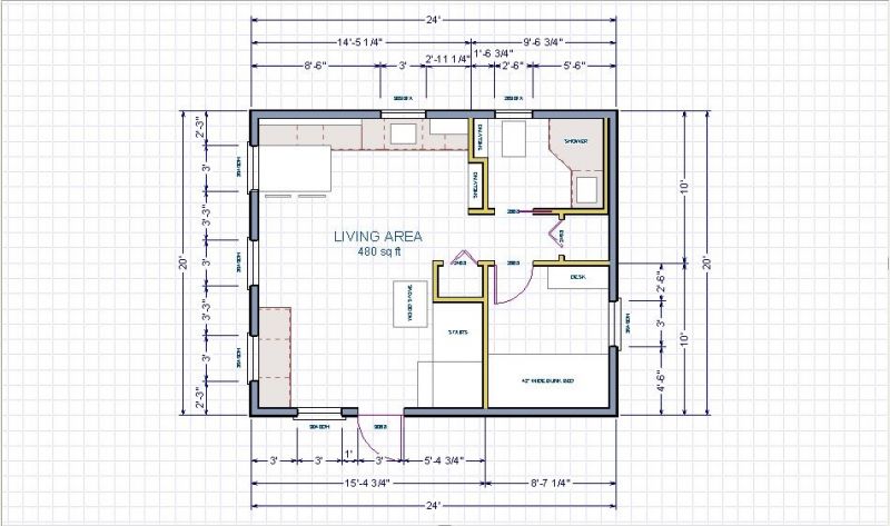

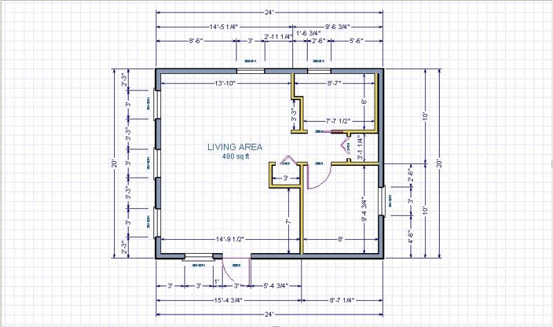

Hi. Trying to figure out a decent layout for a 20x24 loft cabin, originally had a two bedroom signal level plan but the wife isn't happy with the amount of room .main level must have stairs (can be steep), bathroom and small bedroom big enough for bunk beds or twin at max. door is showing on the gable side but would like for it to be on the 24' side. attached is a plan i through together but would love to hear your thoughts.
# Posted: 22 Apr 2018 08:11pm - Edited by: rockies
Everything is cramped. Let's see......bring the bedroom wall with the door in it down a bit so that it is centered in the middle of the 20' exterior wall. The closet between the bedroom and bathroom can remain the same size but you'll get a deeper bathroom.
The bathroom vanity is in the wrong corner. Switch its location with the shower.
Turn the tiny kitchen 90 degrees and run it along the upper wall about 8 feet and then drop the cabinets down to an 18" height and use them for a built-in seating bench on that wall (with a small dining table and chairs.
Put the door on the lower wall next to the bottom of the stairs and put a built-in seating bench on the left wall (they take up way less space than a sofa or chairs but give you storage and seating in one).
The last thing is the bedroom. Turn the bed sideways and create a built-in ships bunk (with possibly a bunk bed above that) and storage drawers under the mattress platform.
Stairs and wood stove can remain in place The closet under the stairs can be the same size but the front wall will be in line with the bedroom door wall.

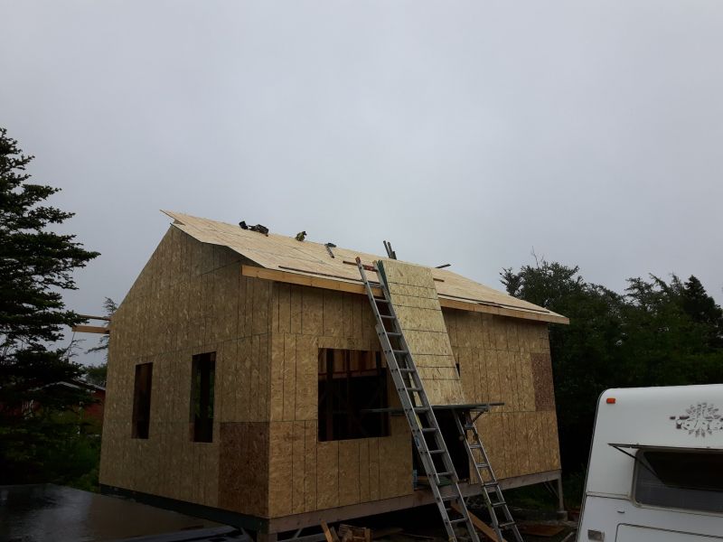

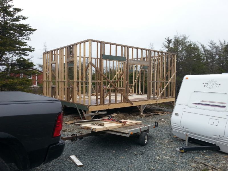

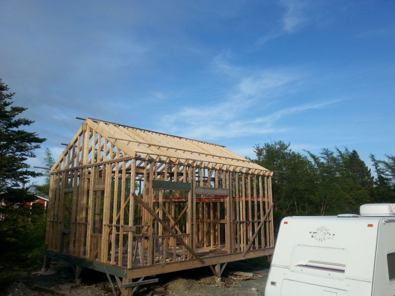

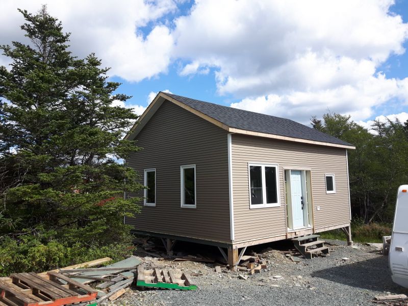

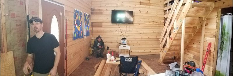

We are building a 24x24 with a loft. The 1st floor living area is 14x24 which includes the kitchen area. Off of this area are 2 9x10 bedrooms with a 6x10 bathroom area in the middle of the 2 bedrooms with a 7 foot ceiling height. The bathroom houses a corner shower, 2 bowl sink, water heater and stack washer/dryer. The loft is over the lower bedrooms/bathroom and is 10x24 area. Half of the loft has an additional overhang of 36 inches (this is where the stairs attach) The side walls of the loft is 3 foot (we built the side walls of our cabin with 10' walls giving us the height needed for the loft) We moved the 1 lower bedroom door over so we could have the room needed to install the stairs without being to steep to climb. As you can see from the pics we have almost completed our build. All in all my wife and I are happy with the layout and it gives us plenty of room for family to gather for a weekend or longer

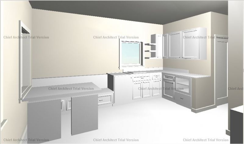

# Posted: 23 Apr 2018 07:41pm

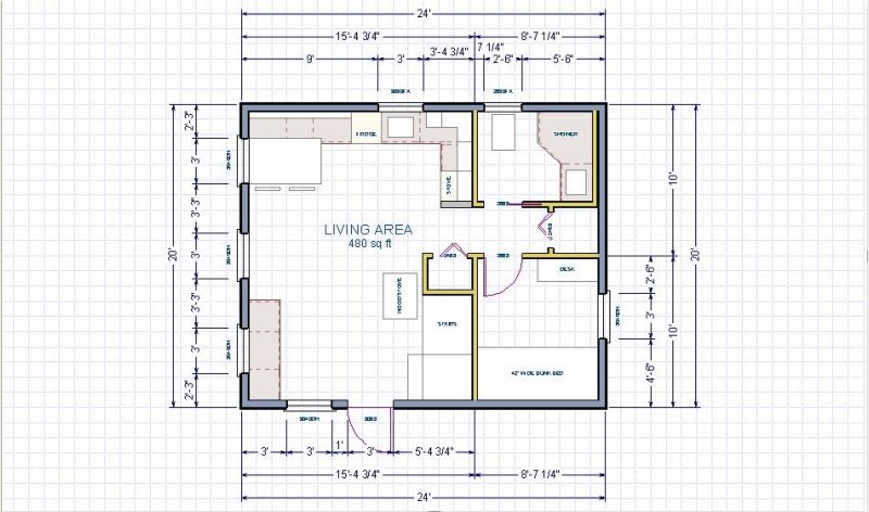

Here are two options. The first has a more basic kitchen (there's a two burner cooktop mounted in the corner cabinet). I also jogged the bathroom wall so you get storage on both sides.
There's an additional interior wall in the bathroom (against the exterior wall) for you to run plumbing pipes (keeps them out of the exterior wall).
The second option has a bigger kitchen with more appliances, such as a 24" stove and room for an under-counter bar fridge.
Dimensions
Dimensions
Option 1
Option 1
Option 2
Option 2
# Posted: 23 Apr 2018 07:42pm

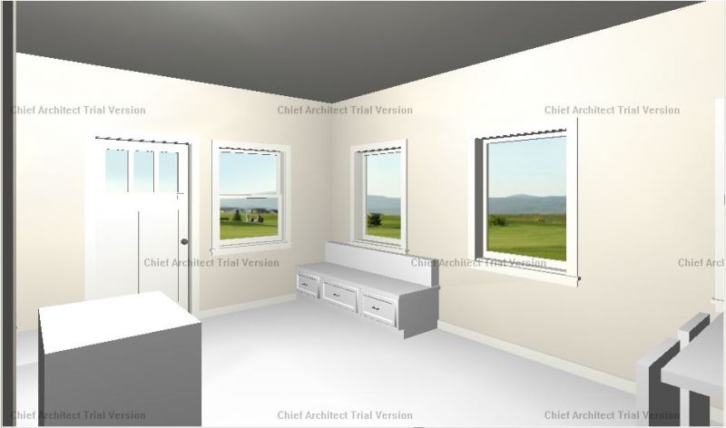

Interiors of Option 2
Kitchen
Kitchen
Living Room
Living Room

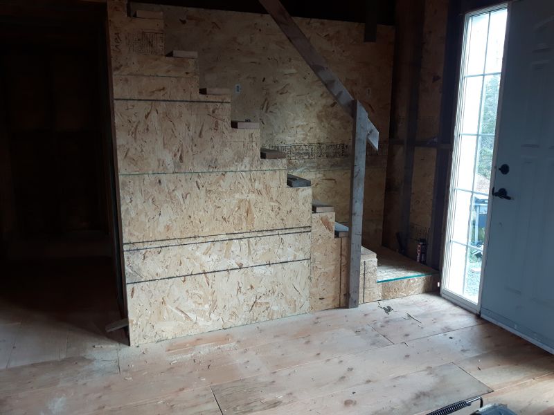

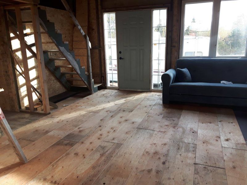

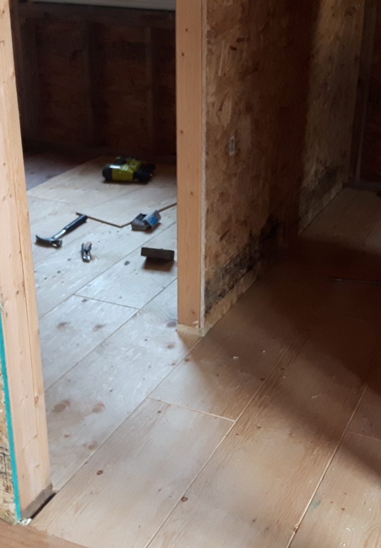

Sorry for the very late replies, Slowly getting around with building the cabin and handling a 18 month old girl. Thanks for the replies, I loved the options u drawn up rockies and sort of going with the option 2. Got it out of the weather for now. Wife really loved the breakfast nook idea
newfie834
# Posted: 5 Nov 2018 09:49pm
Working on the flooring inside now and trying to gather up stuff to finish the rooms. Just closed in under the stairs to loft. Hoping to get the wood stove hooked up before christmas.
