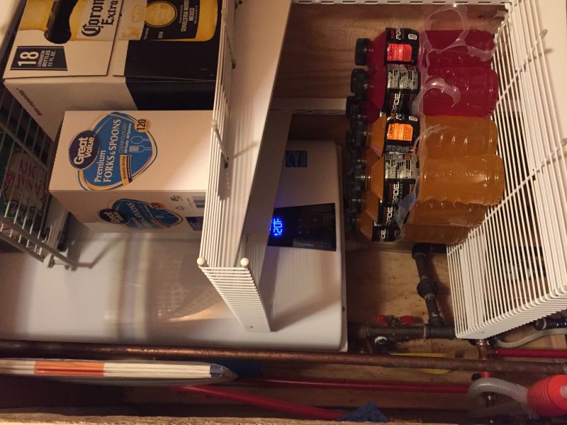

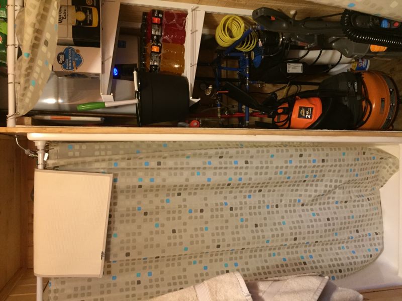

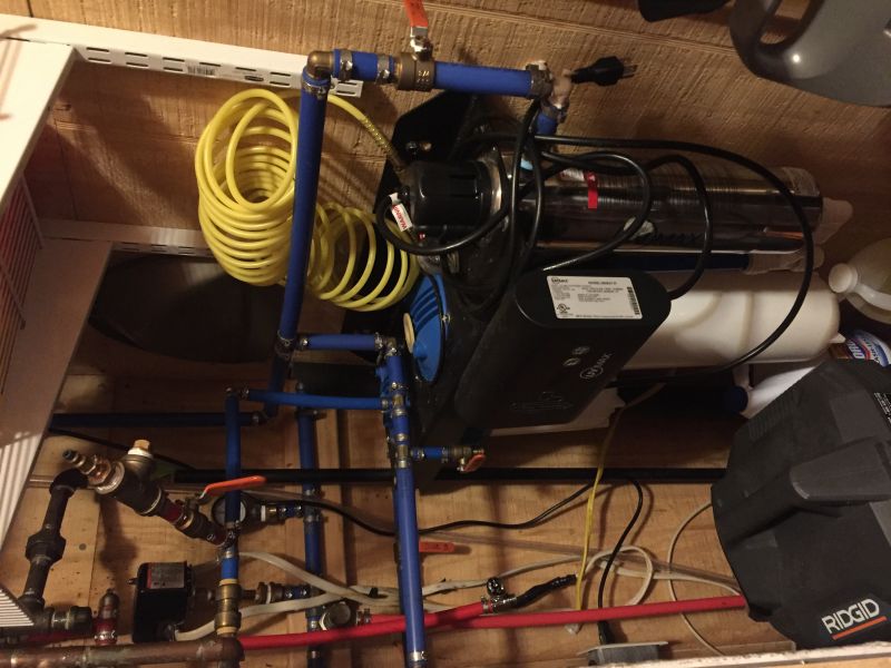

That is exactly how mine is done. I have the main water line coming up from the floor and propane for on demand h2o. We also have a h2o filter system. You will need electric in there as well at some point and a heater cord so things don’t freeze in the winter in your crawl space. I had a plumber do it all and was happy with the outcome. It was a very tight spac to be working in.

Thank you for the pics. Do you have the pressure tank in that little space too? What do you think the dimensions or the footprint of your water system?
