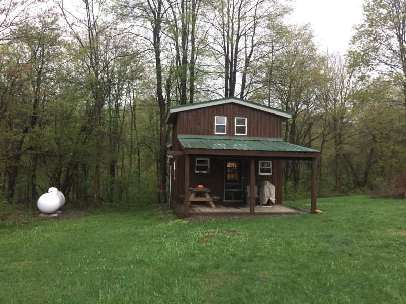

I have one screw leaking on my porch metal roof. While this is an easy fix by replacing with a new screw and washer. My concern now is that my cabin roof could have the same issue. The ceiling in the cabin is six inch spray foam so a leak would not be as noticible if ever if it was a small leak. What would you do for peace of mind?

The roof was probably installed 20 years ago by a previous owner.

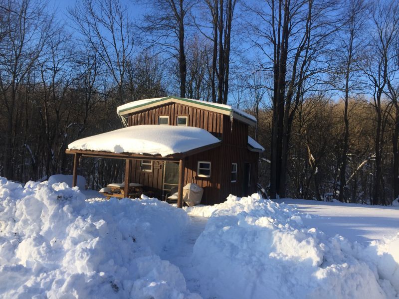

Maybe your porch roof flexed and that caused the leak. Has anybody been walking across it?
gauman2
# Posted: 13 May 2018 06:41am
Never thought about it flexing. I have been on it and the snow loads this winter.
