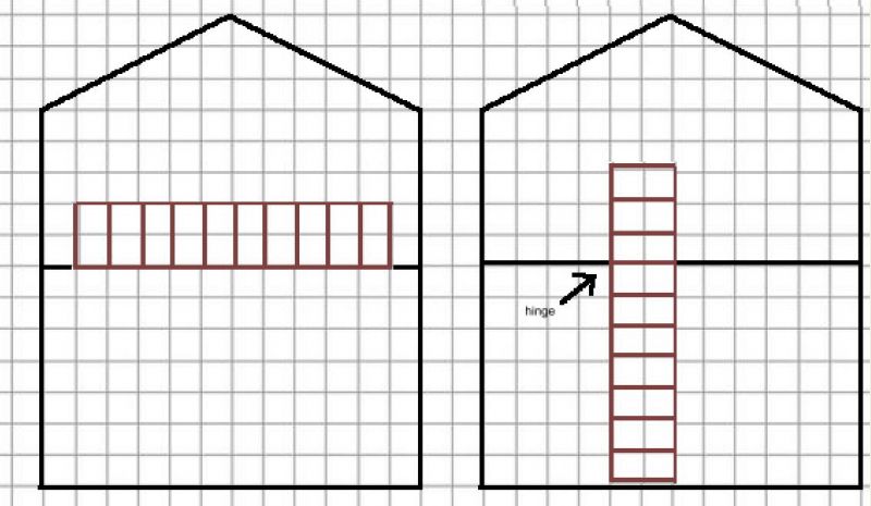

I have built a loft in our small cabin but floor space is a premium. I am hoping for ideas and pics of your loft ladders that stow when not in use. I was trying to come up with a design that could swivel up and latch, possibly forming a bit of a loft rail? Any thoughts? I also saw a post somewhere, not sure if it was here or not, where someone re-engineered an attic ladder to use for their loft. I thin k they mentioned that they reversed it or something? Anyone recall that?

Quoting: jerryotis I was trying to come up with a design that could swivel up and latch, possibly forming a bit of a loft rail?
Hmm, ladder/rail, that'd be brilliant. I think I need to try that, looks like it would work in my cabin.

Awesome, idea. I found someone that did something similar but they had to have a custom swivel attachment made.
http://journal.goingslowly.com/2016/02/tiny-house-loft-ladder

# Posted: 23 May 2018 10:59am
Reply Quote
Dual purposing the ladder is a really cool idea. Unfortunately with most things dedicated functionality is usually the most desirable end product.
A couple concerns. Spacing between rungs may not be safe enough should smaller kids be in the loft, say putting their back to it then tumbling out. (An easy fix might be a second layer with spacing deep enough for feet. This might give you a better surface for mounting a swiveling bracket.)
The other concern is simply the lack of a railing when the ladder is in use or someone can’t be bothered to swing up the ladder.
Then I guess complexity issues around speed of using it if there’s a fire or emergency.
