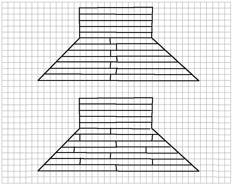

Thanks guys. I'll go with the 16 nail spacing. Here is a drawing of my options on board layout, aside from having all the butts in one line (on one joist). The top drawing has them one joist (2') apart, and two boards per row. Bottom drawing has a board cut in half on every other row, so three boards per row on those rows. I'm thinking this is the way to go.
# Posted: 15 May 2018 11:25am
I like the bottom one, but I'd also cut the full length boards and mimic the lower pattern.....
# Posted: 15 May 2018 11:45am
Thanks Borrego. You're probably right.. be kind a shame though because I extended my mill tracks just to cut those boards full length, that was a hassle. Going into this I figured the less butt joints the better, didn't consider aesthetic consequences.

# Posted: 15 May 2018 12:19pm - Edited by: littlesalmon4
use the first drawing, except every second row put a full board in the middle with a butt joint on either end. This would make the most use of your longer lumber.
oooooooooo/oooooooooo
oooo/oooooooooooo/oooo

# Posted: 15 May 2018 05:55pm
Thanks, good advice. Just juggled the boards again. I can stagger two boards 4-6' except for the last couple rows. Maybe go with 3 boards on those rows.
Atlincabin
# Posted: 15 May 2018 10:45pm
Looks good. I would personally use the longer boards as you originally planned. Less joints is better, again in my opinion. I think you have the right idea with the overlap as planned in your most recent post.
