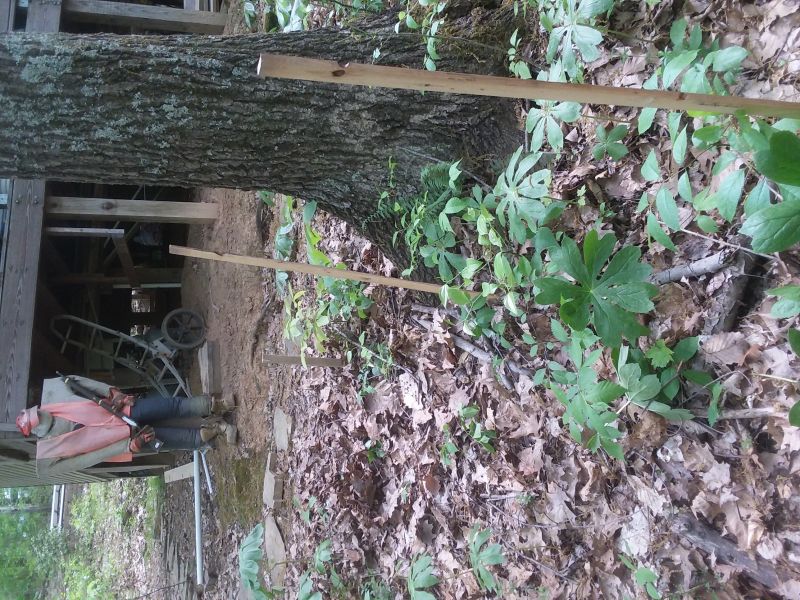

I'd like to extend cabin deck, but an oak stump and roots will be in the way. Normally I'd like to get a footer 32 inches deep or so but i dont think i can chip away that much oak root. The other post/footer locations look fine.
Is there a good way to work through the roots, or should I just stick a post atop a solid root? Other ideas?

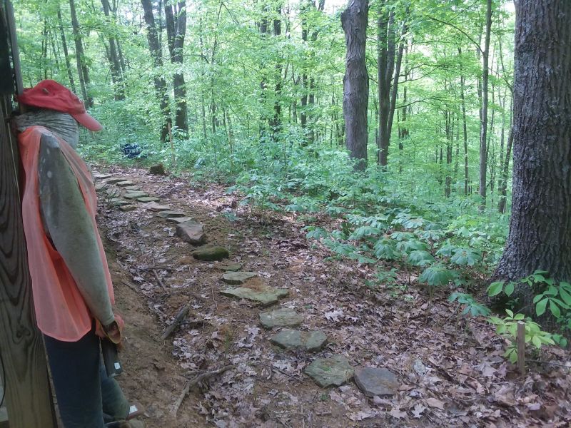

Sammy on construction guard duty
8 12 and 16 foot extension stakes

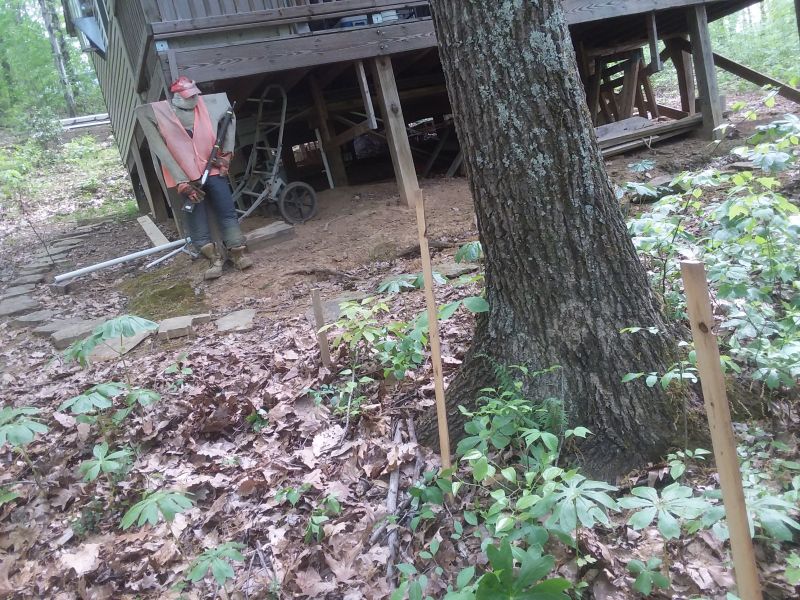

Another view of deck area

Got an old chainsaw? Dig around the root as best you can to expose it and then cut it out with a chainsaw. Wear good protective equipment in case you hit a rock and the chain comes apart (usually just dulls it in about 0.000001 seconds).
Other thing would be to rethink the deck supports to avoid one close to the tree.

Build around the tree. Seen it done, very cool.
You can also cantilever a deck, might need to in one corner. Measure everything and post plans. You'll have the coolest deck in the forest.
# Posted: 14 May 2018 18:18 - Edited by: ICC
Roots of a dead tree will rot, that's one reason dead trees all eventually fall over; you don't want to build on a dead root or stump. Live roots grow bigger; you don't want to build on a live root either. DB's idea of building around it somehow, if it is live, may be the better idea.
# Posted: 15 May 2018 11:28
Yeah, I was gonna say don't build on a root! Building around sounds cool. Or cut the trees down, kill the roots and put your supports where you can....

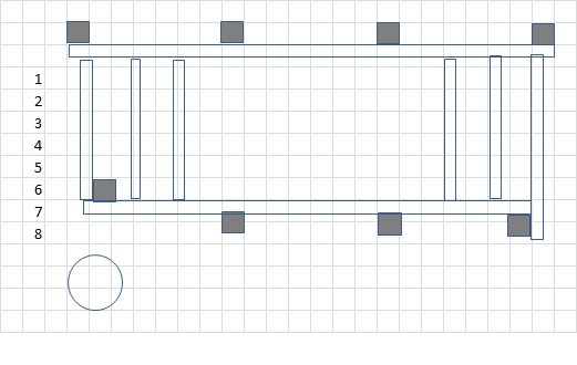

Here is an option to keep it simple.
Go out 8' with three posts, short about 6' for one to be in only minor roots. Left and right ends avoid current bolts, using hangers. Middle uses hangers.
