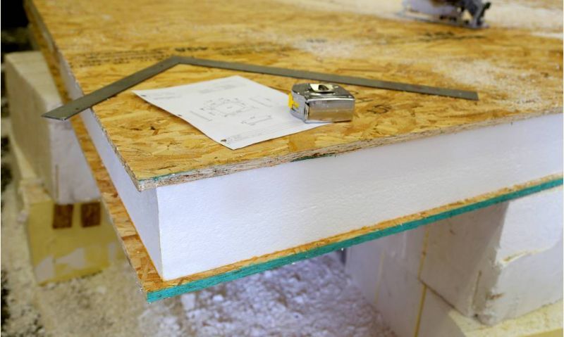

That's what I'm doing, although I'm using SIP panels to build an insulated structural floor. The "raised floor" will be framed on top of the SIPs and have all the plumbing pipes within it so they don't freeze.
You can do the same thing with floor joists but put the insulation in the lower floor. If you're on piers run your beams and then build your lower floor in sections (maybe 10' square running from beam to beam) and attach treated plywood to one side.
Place that section plywood down on top of the beams. Once attached to the beams fill the joist bays with Roxul Comfortbatt mineral wool insulation (doesn't burn or absorb water). Put a vapor permeable vapor barrier (not poly) on top of the section and then attach 1/2" plywood or OSB.

SIPs are a great product for floors because the structure, insulation and vapor barrier are all in one product. Set your piers, put in your beams and set the panels on top and screw them down (follow the manufacturers instructions for installation and sealing panel seams). Make sure you order them with the edges routered out to receive on-site framing members (2 x material).
You can order panels in any size and thickness (from 4 1/2 up to 12 1/4" thick- anywhere from 6-12" is usually best for floors depending on your beam spacing).
Sips also make great roof systems. No eave or ridge venting, no air channels, no stuffing rafter bays with insulation. Just set them on top of the wall top plates and screw them down.
The one difficulty is running pipes and wiring. SIP manufacturers can cut wiring chases into the panel for you but plumbing has to go through interior walls.
I'm using 2x6 stud walls throughout but the roof and floor will be SIPs with a raised framed floor on top to run the pipes. The best thing with the raised floor is that all the pipes stay within the heated interior so no freezing.
Edge Routered for Framing Lumber

What worked for me was something like Rockies SIP picture. I took 4" XPS blue with a higher compression rating. Its jointed so the pieces tie together. Laid that on the floor. THen put tongue and groove 5/8" ply on top. One building is 5 years. Still perfect. Makes a nice warm floor.
