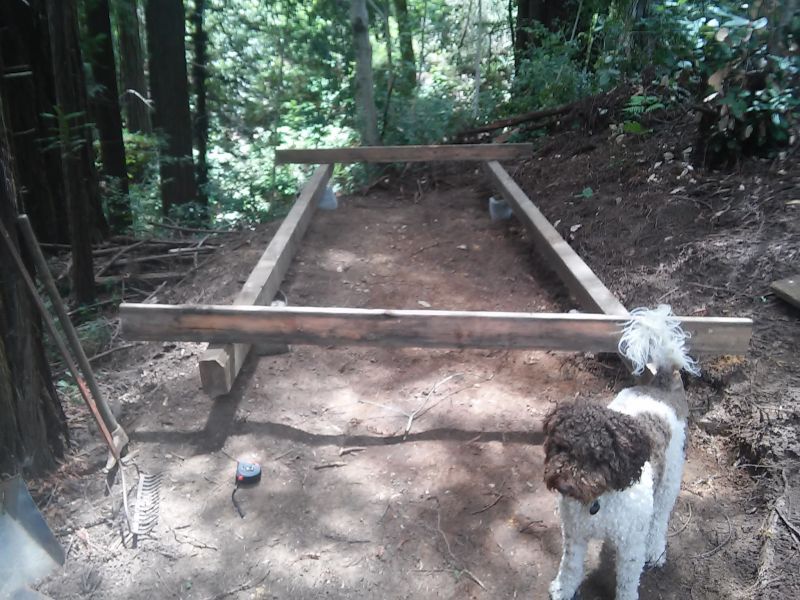

| paulz Member
 | # Posted: 20 May 2018 01:05pm Reply
 Thanks guys.  Here is the hillside area I have been leveling.  My leftover PT girders are a couple inches short of 16' unfortunately.   The test joists boards in the photo are 8', putting them almost into the hillside and tight against that tree on the other side.  I could notch the hill a bit more, wouldn't be easy building on either side of the shed nor getting around it but I guess it would be worth it in the long run.  Once it's built shouldn't be much reason to go around it.

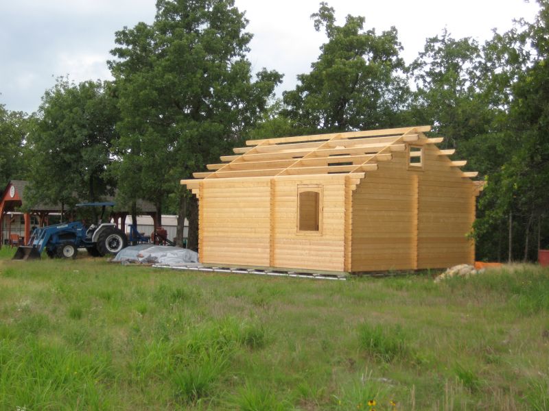

| drb777 Member
 | # Posted: 21 May 2018 09:46am - Edited by: drb777 Reply
 Quoting: toyota_mdt_tech Hey, is a 2X4 (1.5 X 3.5) industry standard worldwide? I think it is or do they use metric lumber in some places?My cabin, built in Finland, is all metric lumber. Since Luomann does everything from forest-to-shipping container themselves, metric was their choice design, but must be the norm in at least the Baltic region.
 Many components are close, but not quite the same as 2X4 or 2X6. This didn't really seem to effect anything since they make virtually all of the components (except shingles & hardware).

 Around me 14' lumber isn't very common.  Yes you will have some waste but 7'x15' won't be that bad.  With that size you need every square inch that you can get.  Actually with the roof you could put small overhangs so that you would have no waste on the roof.

| paulz Member
 | # Posted: 22 May 2018 11:05am Reply
 Thanks guys.  Well I started trying to dig more off the hill yesterday to widen the footprint and promptly broke my pick handle.  Back to other projects for a few days..
 If I can get out to 8' comfortably I will, otherwise 7 will have to do.

| Fanman Member
 | # Posted: 19 Jun 2018 02:50pm Reply
 One thing you gotta watch, digging into the hillside, is leaving plenty of clearance between the dirt and the uphill wall, and keeping it clear.  I've seen a lot of cabins in my area, often when an addition was built on the uphill side and the hillside cut out for it, where leaves and debris accumulate against the wall and rot it out.
