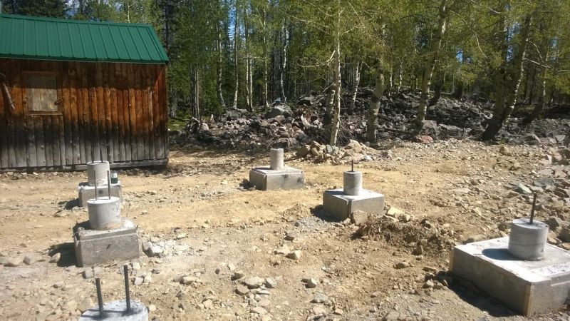

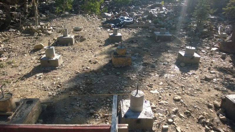

You need to provide a base for the snotubes and tie it into the bed rock. I had the exact same thing going on, except mine was on a old glacial rock...
