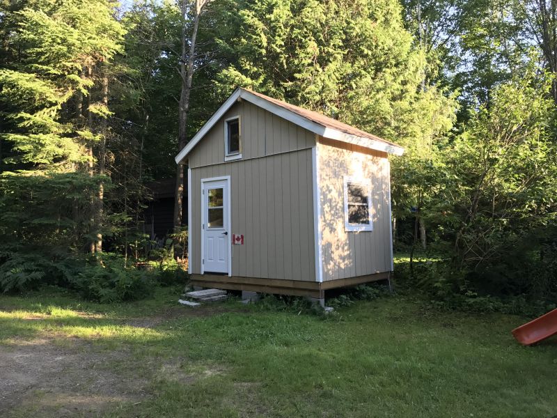

You should remove the top 8 in. of top soil and replace it with cement shed pads ,the ones i use are 16 x 12 in. two or 3 at each pier.. then use cocrete blocks filled with cement to rays your skids to your desired hight . For a 12x 16 I would go with 2 6x8 skids on 8 piers. I have built a few that way.
9x12
9x12
