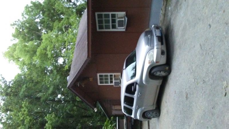

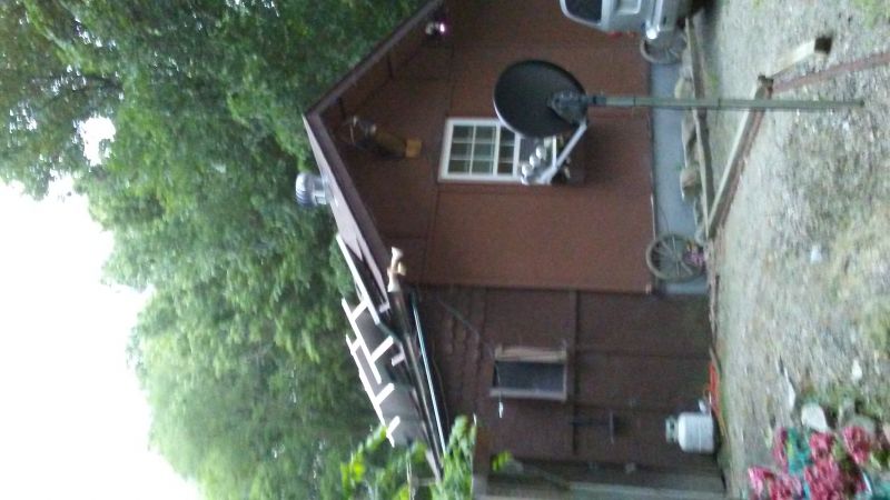

# Posted: 14 Jun 2018 09:45pm
I did the mid section first like nate said. 9 foot ceiling. Then added the other rooms. 0614181941.jpg

# Posted: 15 Jun 2018 11:29pm
You are correct. His sketches look similar to my cabin. That I built in stages. Like what they want to do. You are also correct about the snow loads and ice dams etc. The quote however doesn't describe the sketch. It described an A frame. Read it and look at the picture. Don't mean to ruffle your feathers.😀
