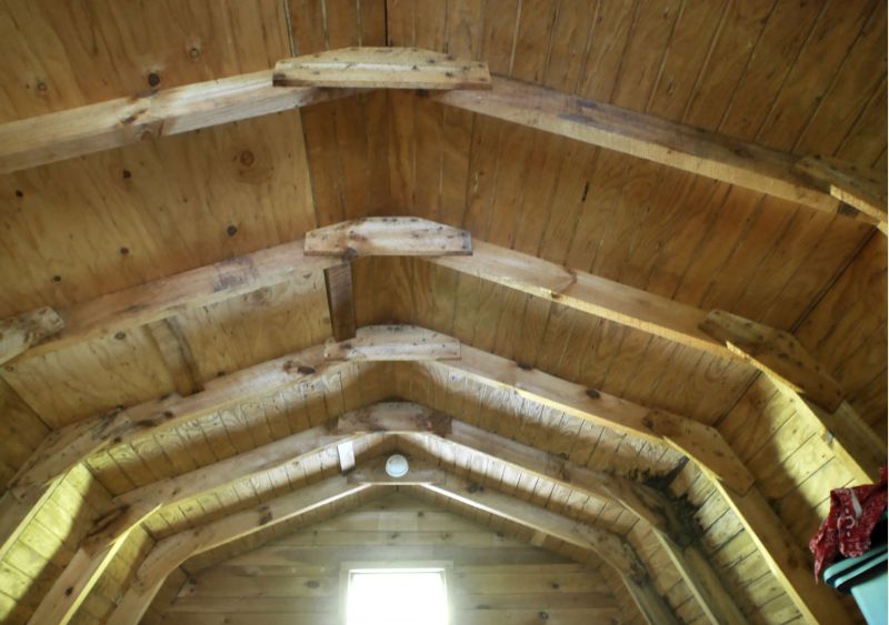

I still have not determined the best way to insulate my cabin on a limited budget. Temps get down to -15 F, so I need to do something.
The photo shows the sleeping loft, about 12 x 16', a bit less than 6' high at the peak. The beams are pretty shallow.
I got a quote from a spray insulation guy to spray it on the ceiling (without finishing, covering or venting it). But then how would it be finished/covered to allow for moisture venting? Does spray foam need venting to the outside?
Would it need a roof ridge vent?
I am tempted to just buy rigid foam and cram it in there with a gap between the roof and the foam, and leaving space at the bottom for it to vent out, but not sure.
Creative low-budget ideas are welcome!
Thanks!

The good about foam is it acts as a vapor barrier, the bad is, if there is a fire the smoke from the foam will kill you quick. Should be covered with a fire resistant material. Personally, that small area could be heated with a good woodstove with no insulation. Even a bad wood stove, but would look for one with a long burn time. Just my two pennies.
# Posted: 21 Jun 2018 03:20pm
Since you have such limited headroom, you are stuck with few options.....fill those rafter bays with insulation and drywall/TG over them is probably the most economical. You can install rigid foam on the roof and then reroof over it.....

It is a very small, though cozy, sleeping loft. We heated it with a good electric space heater, which is fine most of the time, but when it was down to -15 F outside we couldn't get it warmer than 30-40s (that was the extreme).
Borrego, if I fill the bays with insulation and then drywall (or better, tongue and groove) over it: what about venting?

Staple up some attic vents then get your spray foam guy to spray it. 3" of spray foam has a R20 rating.
# Posted: 21 Jun 2018 09:02pm
Like Princelake says....or put a roof ridge vent in....
# Posted: 22 Jun 2018 08:48am
If you stuff polyiso sheets in, cut them a bit loose and then spray foam the edges. You'll get a better seal.
Foam on the outside of the roof, as Borrego mentions, is a great idea. I did that. Worked a treat. And it eliminates the thermal bridging off the joists.
Inside like that, I would think about Roxul (mineral wool), not as high a R value, but fireproof and non-toxic. Plus you'll get some sound dampening.

I have a similar sleeping loft to you, only smaller and same type of roof. What I did is I cut a ridge vent and holes in soffit. I covered holes in soffit with screen so the bugs dont get in. Then I used rigid insulation with 1 inch gap between the insulation and roof sheeting. I cut the insulation so it fits between the rafters and sealed the gaps. Had it like this for over a year and no moisture problems.

My 10 x 16 has a 12:12 pitch so I put in collar ties about a foot down from the peak. Then I used 1" rigid foam and secured it to the underside of the rafters and taped the seams. This created a large air pocket between each rafter up to the triangle pocket at the peak. I put in two vents in that area and screened in the lower opening of the space between each rafter.
This doesn't provide a lot of insulation but my loft is closed off of the cabin area when trying to heat up the living space.
My shingles are kept cooler because of the natural airflow under the roof .

The problem isn't really how to insulate the roof, the problem will be what happens to any moisture trapped inside the ceiling cavity. Not only is there moisture from cooking, indoor plumbing and also from the human body but there can be a tremendous amount of moisture driven into the roof structure from outside.
Most people think that if they stuff the rafter bay full of insulation they've created a sound roof, but then there's the venting, the air baffles, vapor barriers etc to deal with. Coupled with that a lot of people have very small roof rafters, so for a 2x8 rafter, once you subtract the air gap (about 2 inches) you only have about 5 1/2" of insulation, which isn't great.
The best method is to spray foam the underside of the roof sheathing. This product creates an insulation layer as well as a vapor barrier all in one so you don't need to vent or have an air gap. The interior rafter bays must be covered as a fire safety measure though.
Why not try a DIY product like Tiger Foam? They will ship you out a kit sized for your project and when it's used up they take back the tanks for you.

Rockies, I did get a quote to have spray foam done, which wasn't too expensive. But he never explained about the venting situation.
So, with spray foam, is there no moisture that forms? Or does the moisture form on the exposed side of the dried foam?

Moisture is always in the air. The reason spray foaming the underside of the roof sheathing is such a good method of insulating is because the foam causes the interior surface of the wood to stay much warmer so that the moisture in the air won't condense on the sheathing (especially in the winter) and start mold growing.
The benefit of not having to vent is a bonus. Since you will have to add an interior finished ceiling (probably t&g boards would be easiest) don't add a poly vapor barrier behind the finish ceiling. The plastic would only trap whatever moisture does get in and lead to rot.

So, with closed-cell spray foam, you don't need to vent? You only need to have the exposed foam covered (t + g boards), correct?

Yes, no venting required with closed cell spray foam. It's really the best solution for cabins that only see seasonal usage.
Closed cell spray foam has the following qualities...
Thermal Break
Insulation
Vapor barrier
Increases shear strength in framing, glues everything together.
No venting required.

Correct. BUT, it has to be applied correctly and thoroughly so moisture can't get behind it.
A big potential downside is that if you develop a leak in your roof you could have a lot of rot occur before you discover it.
