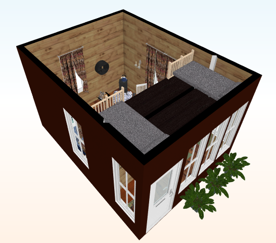

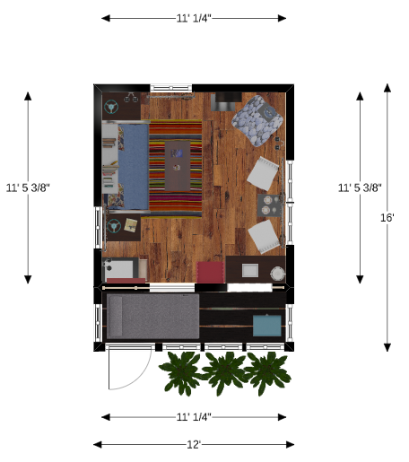

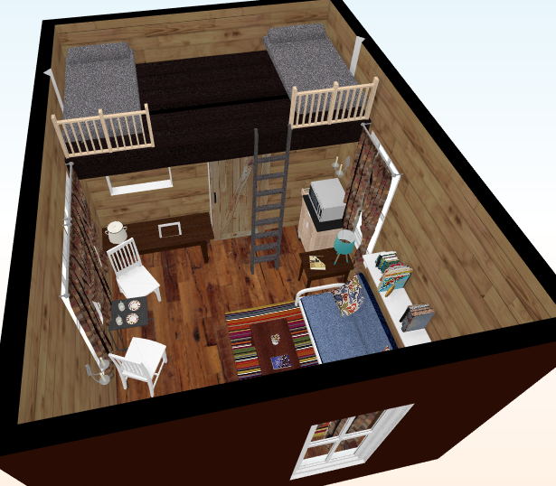

I'm not an architect, builder, or designer. Just tinkering with ideas and learning as I go. Here's what I've been playing with so far, and I'm quite ok with being told it won't work... Any ideas or expertise is appreciated.
NOTE: I decided to extend the loft (pics 2 and 3), since the ceiling will be high enough.

If foot print is the issue. You can build a larger version of a Bay window where your kitchen is. That can give you enough space for RV size stove/oven, sink, dorm size fridge and some counter space. If you add another where you eat, you can put a flip up table, and if you put a counter top in the bay section, you have a place to put the food without taking up space. If you put windows in. Like above the sink, and by the dining area, it still is technically a bump out or Bay.

If you plan on a sleeping loft do be aware that heat rises and lofts are always warmer than the main level. Maybe you already know that and have experienced it. I have and I always find the loft too warm if I am comfortable on the main level.

Do not build the loft connected to the walls or wall studs. Install 6-6.5 foot long studs next to each wall stud for the depth of the loft, then install the loft joists on top those studs. (Can't remember what they are called, they have a name) That transfers the loft load to the foundation correctly. Add one fire blocking 2x4 horizontally between those wall studs and one between the joists/studs to ensure the loft studs and loft joists stay put. (ICC, for ten foot span, what size loft joists, 2x10's, 2x12's??)
Maybe I'm not visualizing that correctly, but wouldn't that mean you only have 6-6.5 feet of space underneath the loft? Given I'm 6ft tall, that would be too low for me.

Well mine is somewhere between 6.5' and 7'. I have no issues as my joists are fully exposed.
Bear in mind, the floor joists for the loft are sitting on a separate 2x4 6-7' from the floor below. Not unlike when you frame a window. The shorter stud was commonly called a cripple stud. It's held in place by fastening it to the full stud.

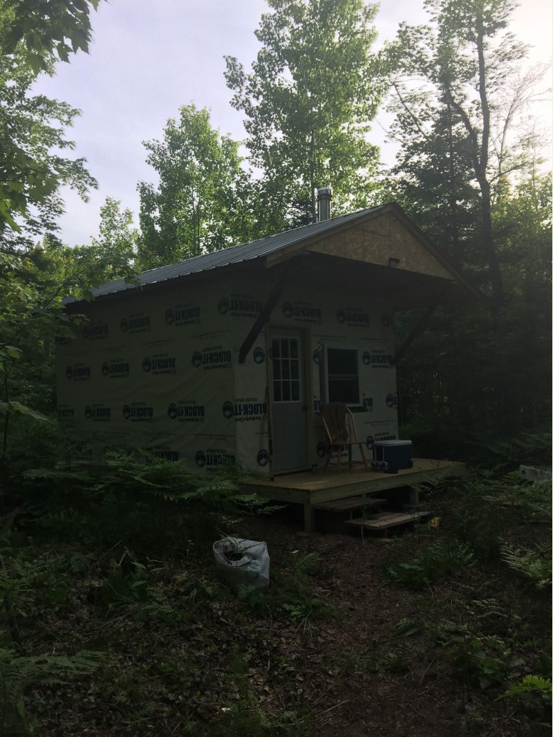

Last year I build a 12x16 (craft shed) in the Western U.P. I went with 10 ft walls and looking back I wish I did 12' walls. I didn't build a loft but the extra height makes it feel much bigger inside
