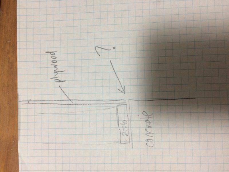

I've finally gotten around to siding the cabin, but I'm curious about this potential air gap between the foundation and the wall.
I'm thinking of potentially using blue skin (or some other kind of tape) to seal the entire bottom perimeter.
The wall has Typar that hangs over about 4".
The cabin is on an extremely windy lake.
Thoughts?

**** I have no idea why that picture is sideways!

You need a piece of 'L' (1x6) flashing under the ply, that's all...if you want to put some sealant on the bottom of the L, that would be ok, but not necessary.....

The drawing shows what I interpret to be plywood sheathing. Or is the plywood on the drawing the finished siding?
If built already, if you can still pry the lower edge loose and insert a z-strip, that is best. Tapes, caulks can fail. If that plywood is the finished skin then I'd use a highest quality caulk.
If not built already notr that you can use a layer of foam under the sill. Look for sill gasket as well as the z-strip under the lower panel edge.
And yes many 4 foot wide panels are available in 9 or 10 foot lengths which permit overlapping the foundation.
# Posted: 7 Jul 2018 09:52pm
The 'L' flashing should go at the bottom, where the siding will meet the concrete.... Z-Bar, like ICC is talking about, would go between the two sheets of siding at the 8 ft line....

Not sure I'm explaining this properly. The above diagram is already built. I am going to add tin siding in the next few weeks. The tin siding will overlap the concrete about 2".
So can I just caulk the small gap between the plywood and the concrete or a wider (perhaps 6") membrane, such as blue skin all the way around?

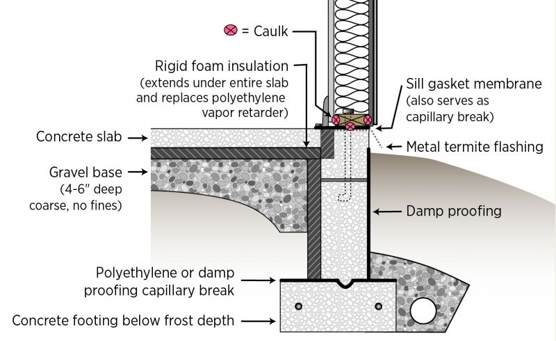

The sill gasket and termite flashing go on before erecting the wall.
# Posted: 8 Jul 2018 05:58am - Edited by: DaveBell
See if you can fit a shallow (1x1) flashing under the wall. If so, Use an exterior caulk and caulk the gap and push the flashing into the caulk. You will have air seal and termite barrier. If not, caulk the air gap and nail the flashing on the sill so that it bends outward.
