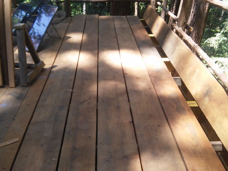

I'm reading that a board will be at it's widest in summer, because hot air holds more moisture. But what about a soaking wet deck board in winter, won't that absorb more moisture?

It will probably absorb a certain amount and reach a point of equilibrium. The best thing is not to fasten it down so that it can't move at all, which will only split the board eventually around the screw heads.
The best method is to use those slot fasteners that go between the boards and you screw down through them into the deck joist. Then the boards can move a bit.

You read my mind Rockies. I'm finally ready to fasten down my deck boards, which are 12-14" wide, and I'm worried that being that wide, the screws will inhibit movement. Probably why deck boards are normally much narrower. Those screws you mention sound perfect, now to find them. Thanks!
Testing a 1/2" gap, figuring 1/4" swell come winter.

I guess that may be a matter of opinion or how one defines "much" movement, or what the project is. Depending on species and how the board is sawn, (radial cut or tangential cut, for example), a 12" wide board can expand or shrink 1/16 to 1/4" across the width. It is proportional, if a 12" wide shrinks 1/4 then a 6" wide will shrink 1/8". For many things that is a lot, other things it may not be noticed or at least not a big concern. If the wood is green or freshly treated PT, the movement can be much greater. I've had fresh felled and sawn pine shrink 3/4" over a 12" width from green to dry.
Wood that is wet from a heavy rain is not really a fair comparison to wood that is just exposed to high humidity. Very broadly stated, the MC , moisture content of wood in a 30 to 50% rel humidity will be about 6 to 10 percent. Wood laying flat and being rained on could easily get to a much higher MC.
