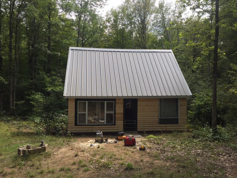

My new-ish to me cabin is around 30 years old.
i have discovered some rot in the framing under the front window and door. I suspect it might be in the supporting wood and also potentially into the floor joists!
How can i repair this without the roof collapsing?
Do I put i supporting jacks from the stronger parts of the floor to the roof?
I suspect i have to take out the plywood floor near the front where it is rotting and inspect...do i then twin the existing joists? would i need to jack up the cabin?
sorry for all the questions, but i haven't ever done anything on this scale before.

I have seen a supporting wall erected from the floor to the joists that take the load off the affected wall.
You basically frame it like a load bearing interior wall about a few feet from the outside wall.
I personally would inspect the floor first to see if the floor joists are in good shape. The work my way up
Yes, it sounds like quite a task but the cabin looks like she's worth it!

Yes, open up the plywood floor. You need to find the extent of the rot before deciding on a plan and temp wall(s). Post pictures of the extent of the rot. Is that a log cabin or framed walls with siding?
# Posted: 22 Jul 2018 02:11pm
Looking at the slope of the terrain, it appears that rain water may flow directly at the front door thus causing the rot. What kind of foundation does the cabin sit on?
# Posted: 22 Jul 2018 06:19pm
Is the rot under the window in the sill or at the bottom of the wall?
I suspect the cause of the rot under the door is caused by "splashback". The water pouring off the roof is splashing down onto your front ramp and wetting the door. With such a steep roof pitch you should install a larger than average gutter and downpipe and run the water well away from the cabin.

Also, do you have a regular flat ceiling inside or open cathedral style? Lot harder to build a temp support wall for a steep pitch slope like that....you have to brace it off or your roof willl fall in....

Yes I have put a French drain in front of the front with around 2 ft of gravel. I suspect before that the drainage was causing it and also the splashback as before there was an asphalt roof and not metal.
Inside is cathedral so yes this will be hard to hold up
I won’t be back for a couple weeks so I can’t get pics
I guess I’ll open up the plywood and look ... I’m almost afraid to do it
black_raven
# Posted: 23 Jul 2018 04:08pm
Oh and it’s is framed walls inside

And sitting on piers .
