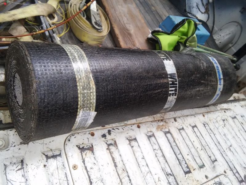

Found it.
# Posted: 13 Aug 2018 11:45am
Thanks guys. Well I pulled a roll out from storage and turns out it is torch down. Not for pitched roofs it says, plus not something I want to get into, unless I could just nail it like regular roll roofing. Might have a flat roof in my future (said the hoarder) so probably save it and use something else.
