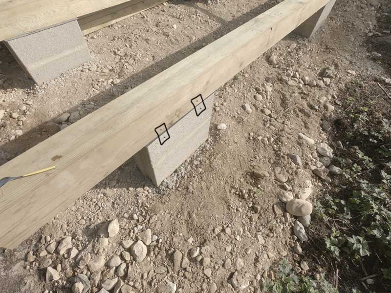

Got another question about the bottom area of the cabin. Is it necessary to connect the beams and blocks to each other with screw plates or similar? Or is just resting the floor framing on the blocks enough?
# Posted: 9 Sep 2018 11:15am
You definitely need to have a solid connection between your beams and foundation. Something like this: https://www.homedepot.com/p/29-lb-Cinder-Block-Pier-with-Z-Max-Strap-098063/202092200 You would have to use some short posts and then a post/beam connector.
Paul_w
# Posted: 10 Sep 2018 03:31am - Edited by: Paul_w
Would something like this do the job? L-shape on one side, plates on the other?
