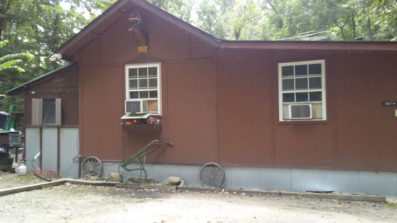

Has anyone used corrugated metal for skirting around your cabin?

I have used metal roofing panels as skirting, not corrugated, but the ribbed type with flat areas between ribs. I get it from a roofing company near me that has the machines to roll the panels from spools of continuous flat pre-finished roofing steel. They can cut the panels to any length. There is a minimum length but it is fairly short, under 20 inches is all I remember. That way the panels can be placed with the ribs vertical and it looks better, IMO. Also there is no need to cut except maybe one or two places where the panel must be narrowed or a cutout for a pipe or something.

Just recently replaced our wood skirting with corrugated sheet metal. Worked great. Very durable and you have to worry about dings and scratches from a weed eater or whatever, like you would with any painted roof metal or vinyl.
