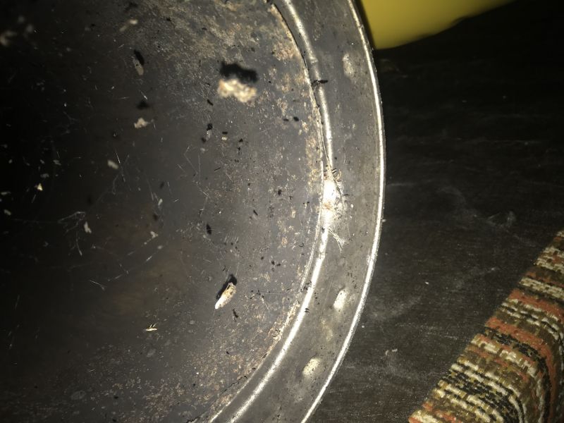

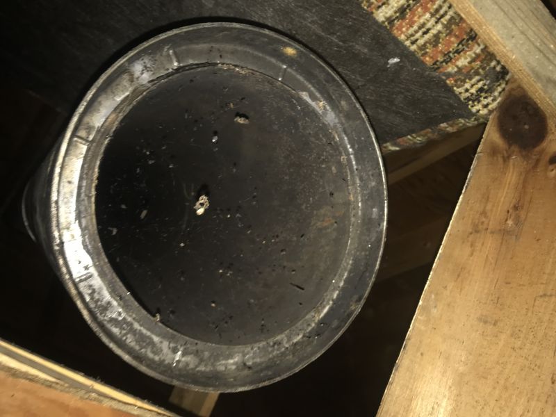

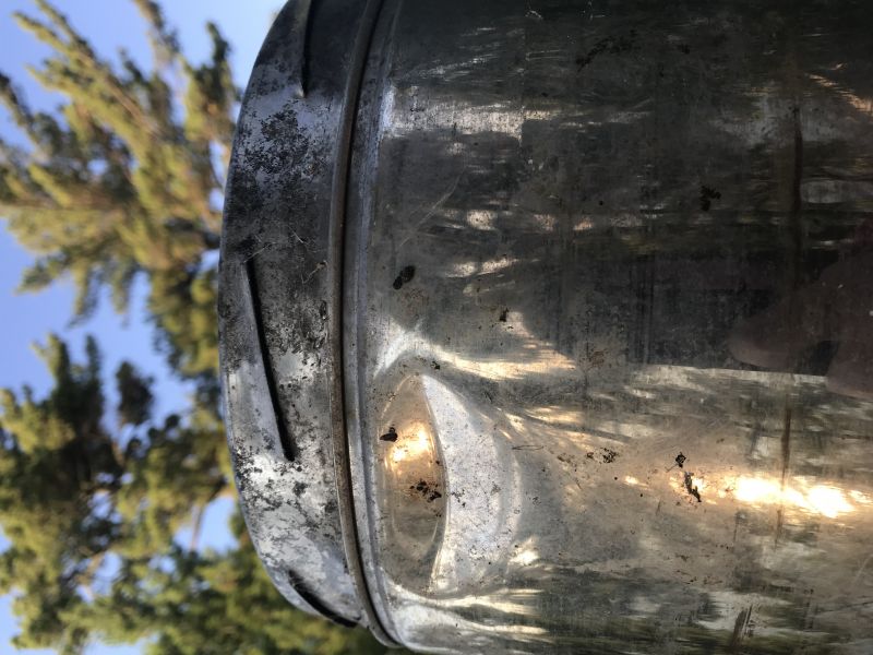

Just purchased a cottage in NW Ontario and the cabin has a chimney pipe installed but no stove, stove pipe or chimney cap.
I'm looking to identify the chimney pipe brand so that I can find a cap and adapter to black stove pipe. Anyone have thoughts on what I am looking at?
One photo is of the top of the chimney pipe outside and the others are from the bottom of the pipe in the cabin. Thanks for the help.
fairscott99
# Posted: 5 Sep 2018 09:04am
Trying to attach photos here.
External chimney
External chimney

This is the second photo.
Internal chimney 1
Internal chimney 1
fairscott99
# Posted: 5 Sep 2018 09:05am - Edited by: fairscott99
Here is the third photo
Internal chimney 2
Internal chimney 2

You may have a few more issues with that install than you think. I would thoroughly clean the chimney to check for any damage before going any further.
How is the chimney supported? I don't see a support in your photo. What is the clearance to combustibles from the chimney? 2" is usually the requirement depending on brand of course.
My advice as a WETT certified inspector is to go to the WETT site and find a professional close to your location. https://www.wettinc.ca

It looks like a selkirk brand chimney pipe. Just installed one in my cabin a few weekends ago.

Thanks for the feedback. Been doing some more research and it sounds like it is probably a Selkirk (Metalbestos) chimney. I'm going to grab some more photos of the full chimney this weekend and appreciate the advice.

If it's heavy chimney pipe (the type that has a poured refactory between the stainless pipe walls), it could be Security Chimneys brand. I have it on my wood stove at home and love it. Outside of the pipe is usually warm to the touch. Here's the link : http://securitychimneys.com/
