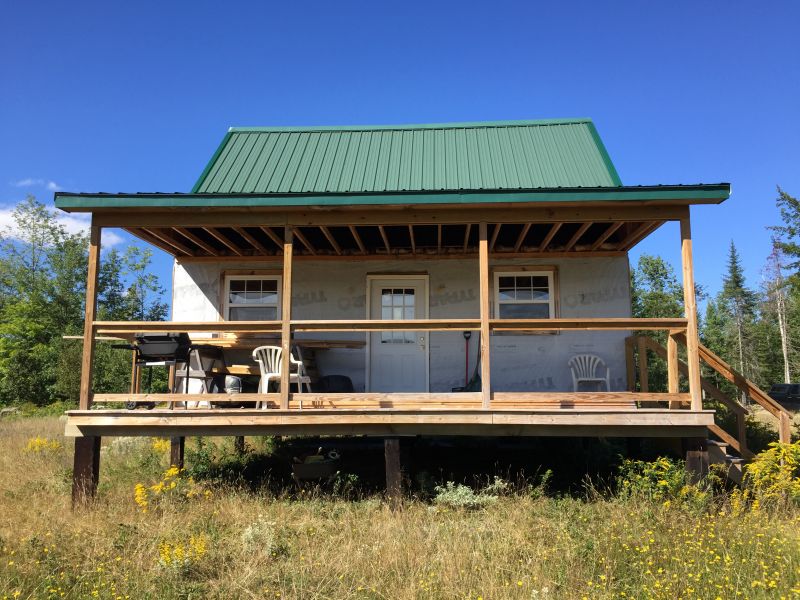

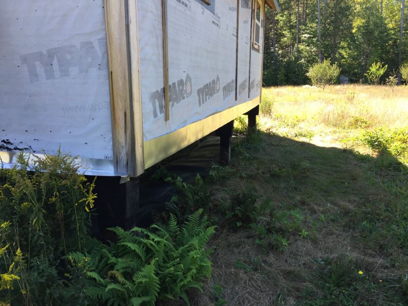

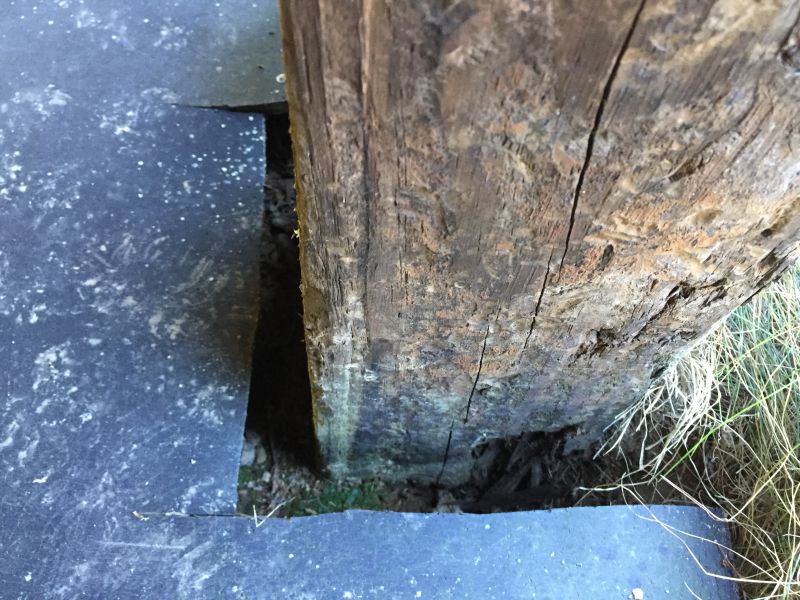

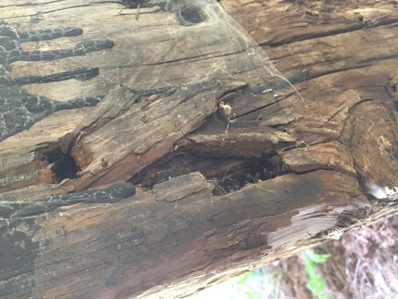

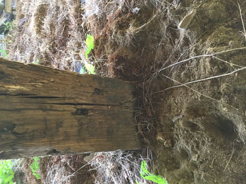

I stopped and looked at a cabin today that I am interested in purchasing. Everything looked solid but I have some reservations about the post foundation. The post are directly buried and appear to be old barn beams, not pressure treated lumber like I would expect to see. I thought they may be sitting on concrete footers but they were buried. The upper ends of the post appeared to have been treated with creosote but I dug a little around some of them and they didn’t appear to be treated below the surface. I’m pretty amateur when it comes to these types of foundations but was curious of others opinions before I make an offer and have it inspected by a professional.

Well, I would say they are going to be trouble. The upside, its still looks solid enough and enough room in there to get in there and replace one post at a time the proper way. I would use treated timbers and cemented in place on a footer.
Its going to be labor and materials cost, so if you like it, figure that in on your offering price.

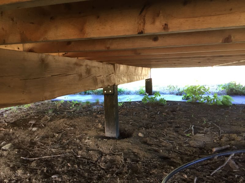

Just a couple of observations/questions. Some of this is tough to tell from a couple of pics.
1. It is tough to tell from the picture but those posts seems spaced really far apart. Maybe it is an optical illusion.
2. What is the post to beam connection? It looks like maybe their is a bracket that lags into the bottom? I realize that this looks like a middle beam but I would be worried about the beam rolling off of the post.
3. Are the floor joists one continuous board or are they spliced? It looks like to me in the 1st picture that the floor joists are not continuous but the joint is not over the beam which I think it should be. They are not properly spliced either from what I am seeing.
4. Was this cabin recently built?
5. Posts do not typically rot below the ground surface. The reason is they don't get enough oxygen to rot. Usually they rot right at the ground surface where there is moisture and oxygen.
Like Toyota said you could replace the posts without alot of issue but it would be some cost and be a pain in the butt. If some of my observations above are actually correct then I would also worry how some of the rest of the cabin is constructed. How did the rest of it look? Many of these issues could be corrected if you can get the place for the right price.

You know I was so caught up with how the post were sunk into the ground I wasn’t paying attention to your other points. I’m guessing the post are about 8’ apart. The floor joist are not continuous, the joint is over the beam but as you said they are not spliced. You are correct about the post to beam connection. It is a steel “L” bracket lagged into the bottom. The center- fowardmost post did not have a bracket and had shifted off the post a bit. All other post had a bracket. The cabin was built in 2015. It’s just a shell, exterior sheathing is covered with house wrap, sheathing was still solid. As you said though now I’m concerned with some of the other construction. Thanks for the input.

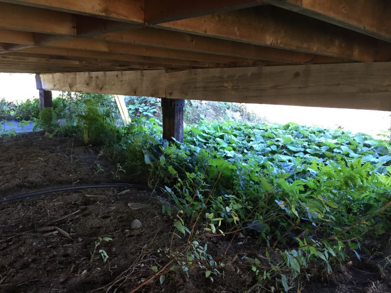

I attached some additional pictures of the cabin.

Also I asked the realtor today, the owners stated the post are treated railroad ties.

I would agree that they are treated railroad ties for the posts. Since the building is still a shell then it wouldn't be hard to correct some of the issues. I would ask the realtor to ask the owners if the posts are setting on concrete or are just sunk in the ground. Like Toyota said it wouldn't be hard to jack up and replace a post at a time. You could also improve the beam to post connection to prevent it from sliding or rolling off. I would add some hurricane straps from the beam to floor joists connections as well especially on the 2 outside beams. As far as the post spacing you would need to look at a span calculator and see what size beam that is for your area and snow load to see if it is adequate.

If it was me, I would go take another look at it and make a list of everything you can find on the building that isn't up to snuff. Take a level, square, and tape measure and see how far off the building is. One thing I see from the new pictures is the post in the middle under the porch doesn't look close to plumb.
