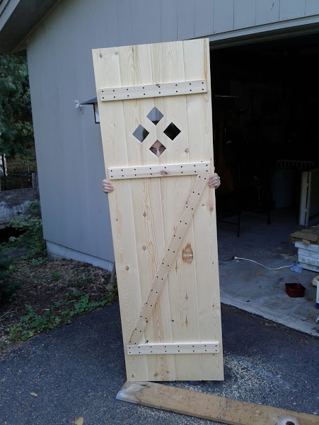

I would agree with Atlincabin overall, but say that you can skip the reinforced with plywood part. I am assuming the access doors will be narrow enough to fit between the studs? If so they will be pretty narrow (~14" if studs are 16" on center, maybe 22" if studs 24" o.c.). And since it is knee walls, they won't be very tall either. So they will be more like cabinet doors, rather than like people doors. Even with small people doors, you don't have to reinforce with plywood as long as they are interior doors and don't see a lot of use. I've attached a picture of the T&G bathroom door from our bunkie. It's 24" wide and reinforced only with 1x3 strips of wood. I'm using bigger hinges than it needs for sure, because I liked the look.

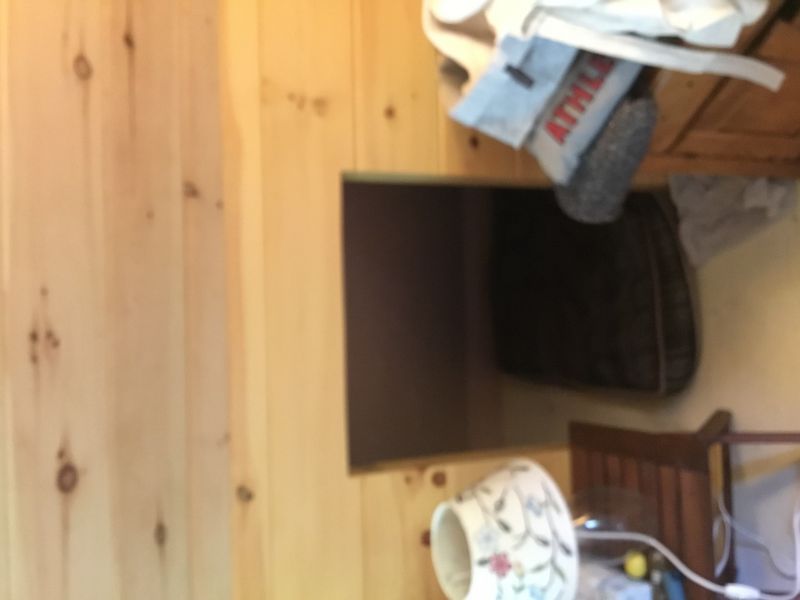

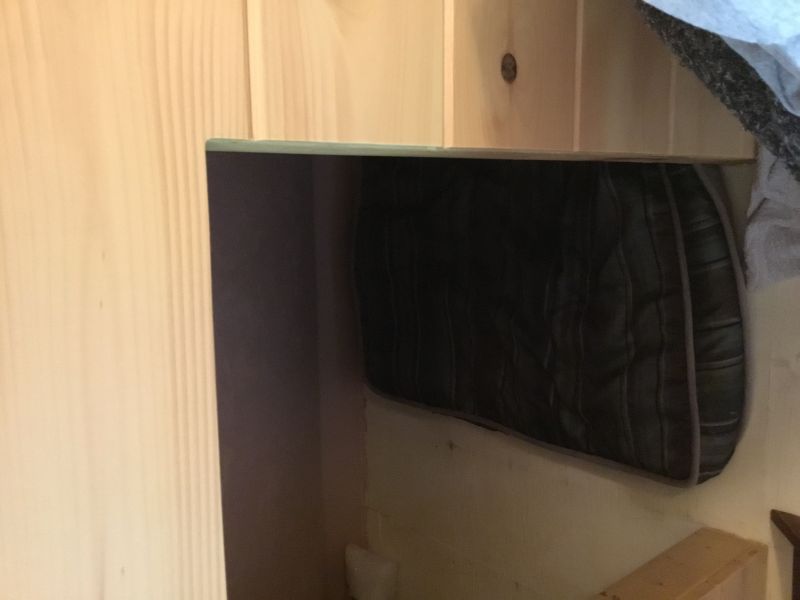

I have my knee walls panelled with t&g no doors done yet. To finish the edges I used a large flush cut router bit and ran it around the framing. Beautifully straight lines and no trim required. I’ll attach a picture when I can.

Couple of pictures of one of four openings I have in my loft knee walls. You can see it would be fairly straightforward to make a plywood door and apply the same t&g stock to the plywood for seamless/hidden door.
Let us see your results if you take on the project.

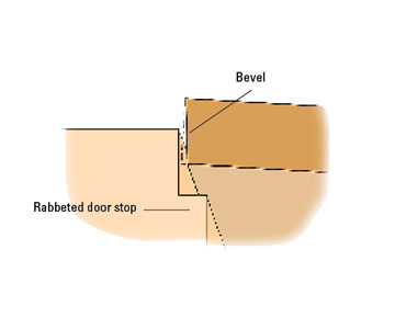

If you want a very tight reveal between the door and the surrounding paneling (so that it almost looks seamless) you'll need to bevel the edge of the door opposite the hinge so it doesn't bind against the wall when you open it (a 5 degree bevel down the length of the side should be fine).
