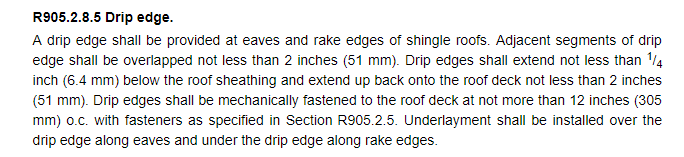

# Posted: 7 Oct 2018 06:20pm - Edited by: ICC
Quoting: Borrego
the drip edge goes on the wood deck, then paper, then roofing material.
Depends what edge of the roof you are talking about. On the rake of a gable roof the drip edge metal goes over the paper, as shown in the first drawing in the OP link, but on the eave the drip edge metal goes on first and then the paper over that. Read the last line in the attached image.

# Posted: 7 Oct 2018 07:31pm
Quoting: ICC
Got it...nonetheless, most roofers i work with always install drip edge under paper. If water gets through shingles or roll roof, it can migrate along the paper and up under the metal edge material. I can see it both ways.....but I'm not one who always agrees with a theory just because it's in the code book.......
