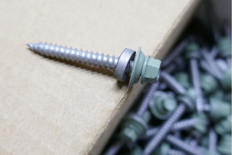

# Posted: 8 Oct 2018 06:39pm
My roofing supplier, local guy, sells a screw I have not seen before, but then I don't look anywhere else anymore. The washer is cupped deeply enough that when the screw is tightened down the cup stops the screw and squishes the neoprene washer just enough to seal. Sunlight never hits the neoprene tho it still gets good and hot from conduction.

Malamute
# Posted: 20 Oct 2018 06:30pm - Edited by: Malamute
Those look like the normal screws for metal roofing.
They spec different type/size screws depending on what material the screws are going intp below the metal. OSB takes the fatter screws, type S, and with the 5/16 head I believe. Screws for going into actual wood and for real plywood (not OSB) are supposed to use the skinnier screws with the 1/4" heads (as shown in the image above). Theres a spec for how long they want the screws in the sheathing. Ive used Fabral and one other make. Check their site, or whatever make of metal you get and see what they spec for screws. Many people, even that sell the stuff, dont have a clue what the correct fasteners are.
And yes, the cupped washer is just supposed to start compressing, but not flatten out when properly torqued.
