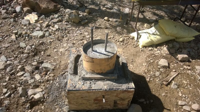

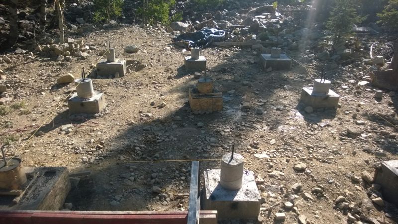

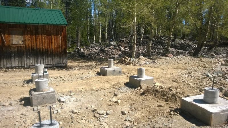

piers done right...never a problem with them. You have to do it right and be able to spread the weight out.
Princelake
# Posted: 11 Oct 2018 05:59pm
Snobdds I was looking at my options for doing footings and I was thinking of how you did those.
Did you pour that square pad first then pour your sonotube?
What was your process and easiest way without blow out?

it's all one monolithic pour. The snotube only extends half way into the box. Its pinned with rebar from the inside. If you look in the background, you'll see a lot of rock. That is old glacial deposits. The box's only go down about a foot before its on the rock. It's was recommend by our engineer to put these in for their ability to hold the weight and act as a solid footing. We've had no issues with these.

Snobdds so when you build your form you have the sonotube go into the pad so theres cardboard left in the form!?!? Or what I'm seeing is a square form then you put a top piece of plywood on it with a hole on it for the sonotube?
# Posted: 14 Oct 2018 01:33pm
I gather with the top over the square pad, he has set the tube in just to the underside of the wooden top, making for a single pour.
snobdds
# Posted: 16 Oct 2018 04:36pm
The snotube is about 6 inches into the box, Cardboard and all. As long as the foundation pier stays in tack and no air gets to the cardboard, it will be entombed forever with no worries.
