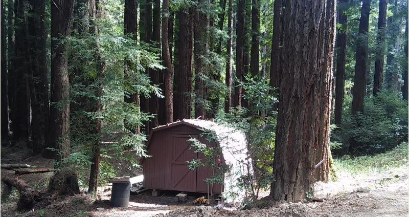

I have a second (now third) shed that was on my property when I bought it. Yesterday I fell through the rotting roof. The rafters are still fine. Thinking a metal roof may be the way to go.

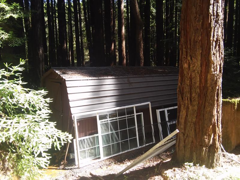

Got yet another shed a friend gave me when it was in the way of his remodel. The metal roof panels it has runs longways, opposite of all the metal roof info I'm reading. No sheathing or purlins, just screwed to the rafters. Maybe it's just one of those cheapo prefab sheds but it seems to work, in fact the contents stays very dry and stable. The panels are not sealed at the ends, I guess it breathes that way.
Can I put a metal roof on the old shed the same way or do I put down purlins and run the panels the conventional way?
(The photo of the old shed brings back memories, dated 2011. I had recently bought the property, that was the only structure. I used to sit in that shed, cold an alone, wondering what I was gonna do..)

It's pretty common around here, for uninsulated farm buildings to attach to purlins. Its a small building so why not go to the rafters? Part of the roof sheathing is to hold the structure together, make it more rigid.
But a building that small?
amazing trees there

Thanks creeky. When you say go to the rafters do you mean run the panels perpendicular to the rafters (like the other shed pictured) which I was hoping to do since it would be much easier? I just though it might trap more debris that way but doesn't seem to bother the other shed.

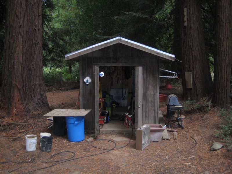

our well house pic
