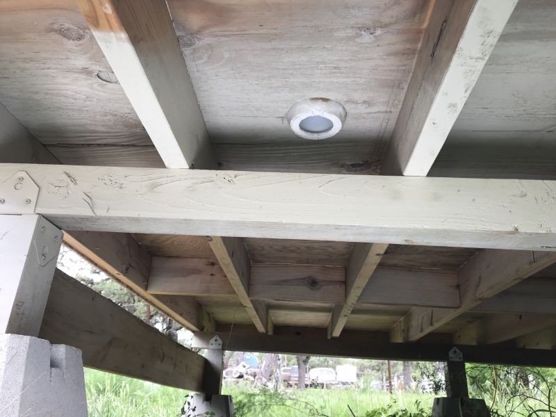

mine is 10' x 20' and used deck blocks with 4x4 going to 4x4 skids. just make sure your cross brace so the don't twist and fall over.

the vertical 4x4 does make leveling very easy. and i did end up running vertical bracing between some them to keep the from shifting. I also have 18" x 18" x 2" thick concrete blocks below the deck blocks to help spread the load out and be able to move them around if needed. The verticals in the picture are on the tall end and then the other end, 20' away, are only 4" tall. I built it with the idea that if i ever need to move it i can drag it up on a trailer with the skids, just cut the verticals off. Or just drag it.

# Posted: 31 Oct 2018 09:48am
Oh, slotting the 2x in there between the 4x4 posts is a very good idea. I haven't seen that before and is one of those.... doh.... that's obvious things.
I have not seen that in any photo of using deck blocks before.
That should make it a much more rigid structure against shear forces.

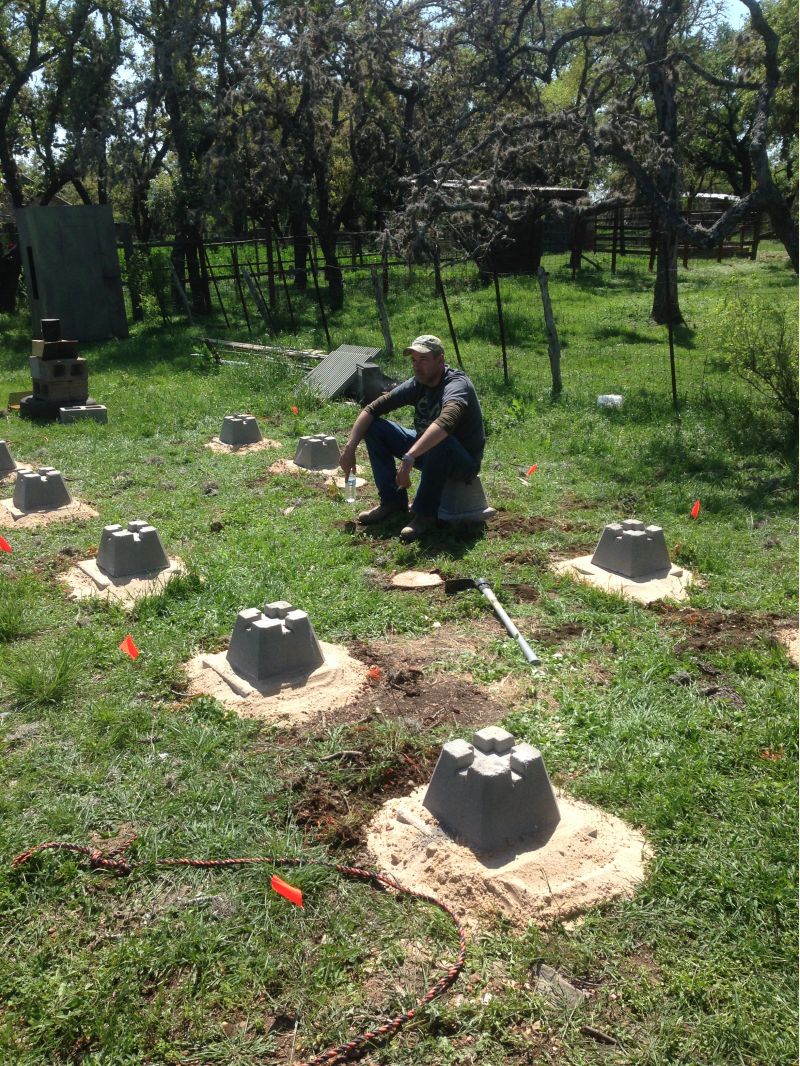

I built the foundation of my cottage addition on deck blocks. I leveled the ground and put in a 2'x2' patio slab down, then put the deck block on that. they have stayed level for 15 yrs now.
