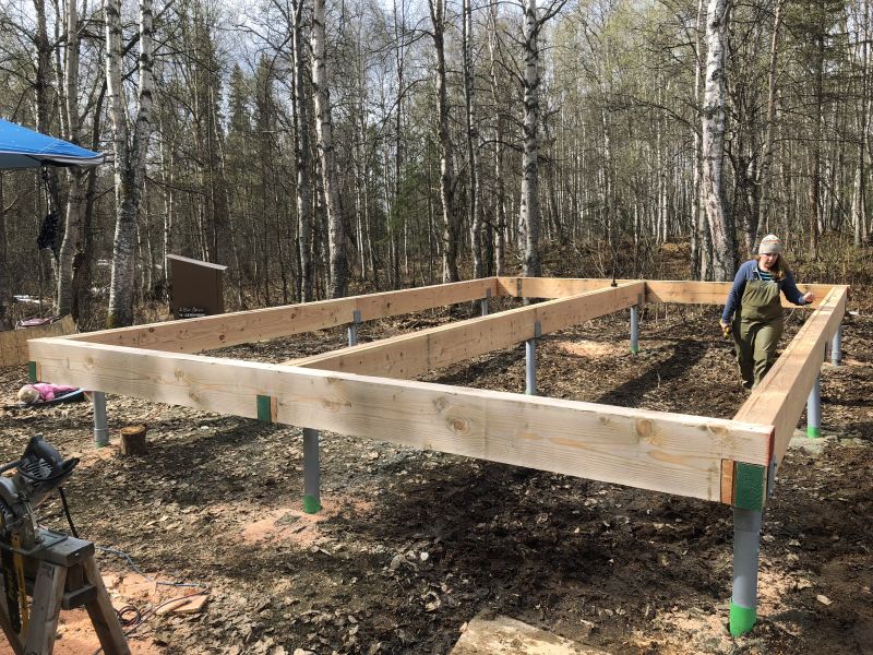

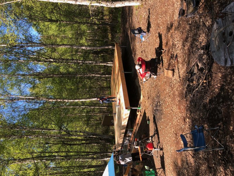

Here is a 16x24 foundation with 3 piles up front that are lower to accommodate the porch. The beams are 6x12 - 24 length ways and 6x12-16 in the front.
These are called helical piers, they sit about 5' deep. We have frost to about 4' on bad years.
Piles with beams
Piles with beams
Decked
Decked
