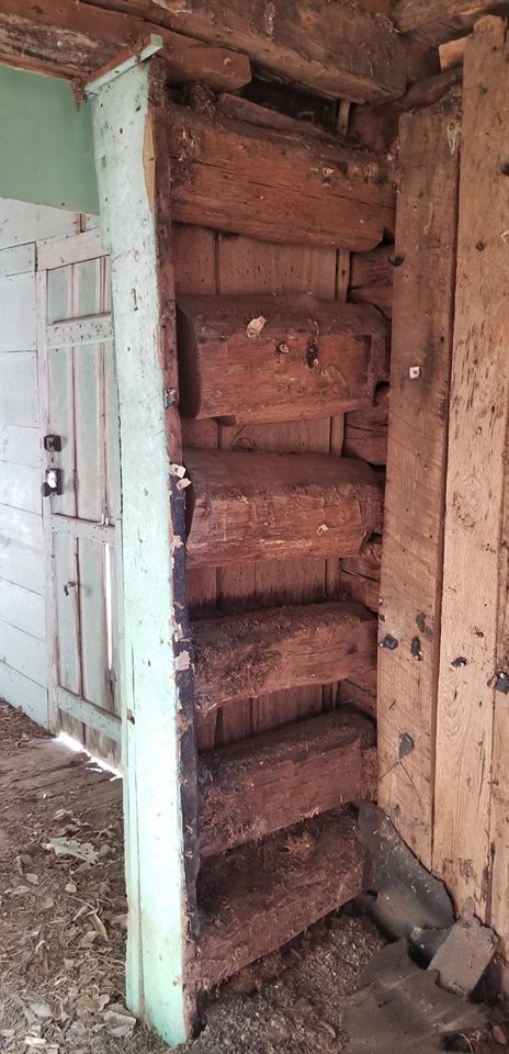

Disclaimer: I know little to nothing about restoring cabins but I am determined to learn.

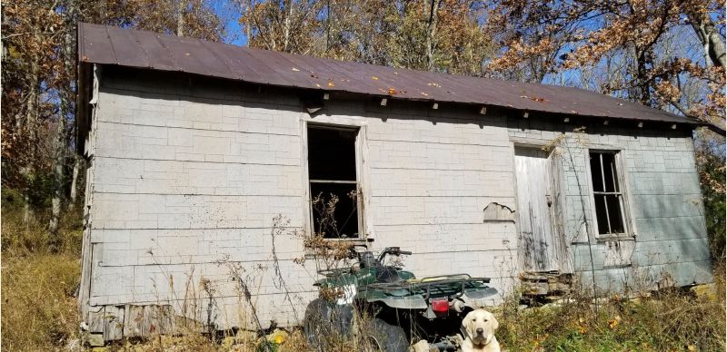

The log cabin in the attached pictures was moved/restored in 1948 but I have no idea how old the original logs are. When it was moved, it was boxed in with 1x planks and covered with a thin siding.

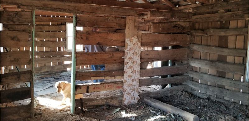

I just began removing the wood from the inside and the logs seem to be mostly ok, with a few exceptions under windows and doors.

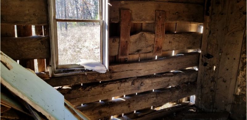

My biggest concern is the large gap between the logs. The pictures of chinking between logs that I've seen on the internet seem to be much smaller.
Initially, does this seem like a feasible project?
Thanks in advance!
Joe
# Posted: 16 Nov 2018 09:33pm - Edited by: ICC
Wide spaced logs like that are common in Appalachia. And the squared off log faces are also common. The squared faces were used so that later on, after the builder had more money, they could install those 1x boards over the logs so it would not look so much like a log cabin. Log cabins were for poor folks and the 1x boards raised you a level or so in society. Same thing goes for the siding that was applied to the exterior; that showed you had moved up the economic ladder.
As for restoring the rotted wood under windows and doors. That alone can be a big job/ Idsit really worth doing? Another route is to totally dismantle the cabin and save all the good logs. Maybe buy another one to dismantle for the logs. A friend in WV has done that and built a great old looking cabin with modern windows, doors, concrete foundation, partial basement, etc.

Thanks for both replies. I guess my main concern was the huge gaps in the logs and if they would be able to be chinked like that. Where there's a will, there is a way.

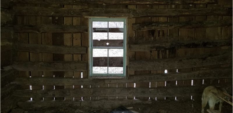

I definitely want something that will last and will work for the large gaps that I have. The mix that includes the sawdust sounds like the best idea so far from a price/practical standpoint.

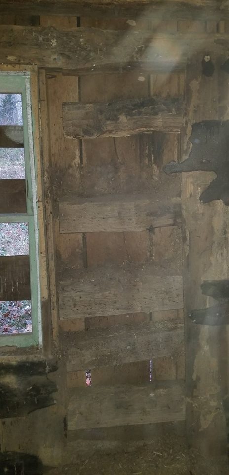

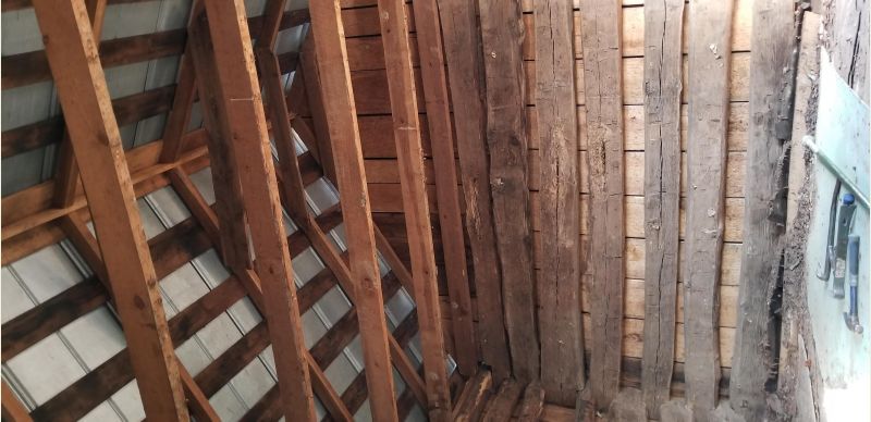

The attached picture shows the rest of what I have to work with now that I have the complete wall exposed.
# Posted: 26 Nov 2018 08:57pm - Edited by: KinAlberta
Could some sort of aged or kiln dried wood be inserted between the logs to reduce the gaps and provide more solid support for the weight of the wall above them, especially where the logs end as at the window frame?
Sojoe
# Posted: 27 Nov 2018 12:43am
I think that is the best way to support the large gaps and I feel pretty confident by the replies that the distance between the logs (while large) won't keep me from saving the cabin.

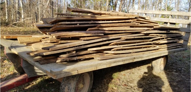

# Posted: 2 Dec 2018 10:29pm
Progress today!
Finished removing all the ammunition boxes, tar paper and 1x sheathing from the inside of the cabin. Tomorrow I will start removing the 1x sheathing from the outside.
One step closer to taking the logs apart and storing them until I prepare the location where I am moving it to.
