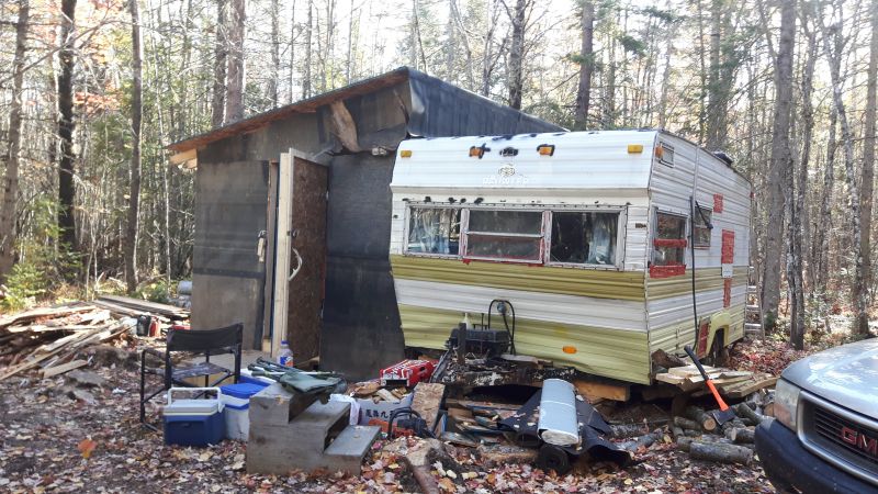

manny
# Posted: 23 Nov 2018 12:43pm
Added i little more room

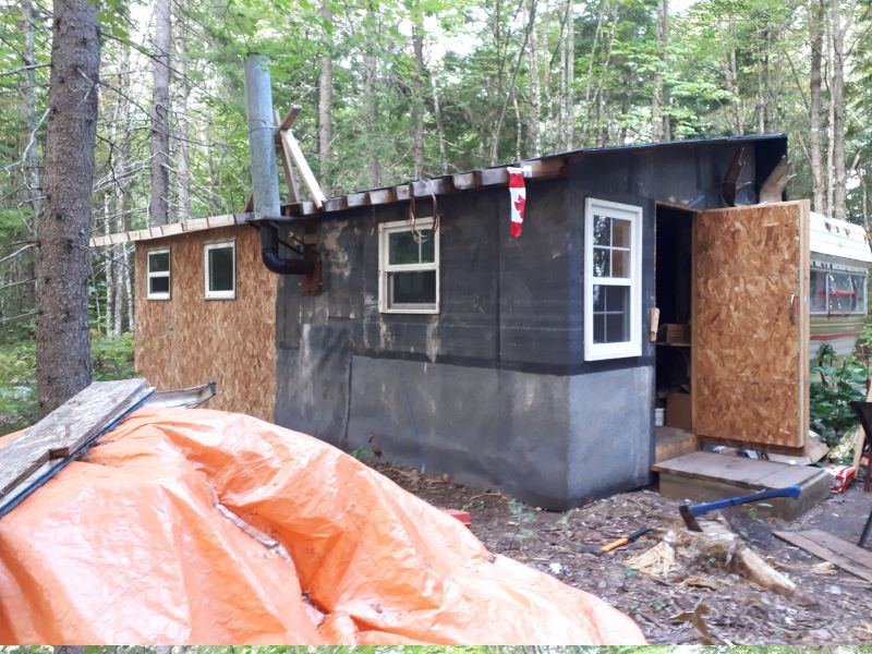

manny
# Posted: 23 Nov 2018 12:46pm - Edited by: manny
this summer
Cabin this summer
