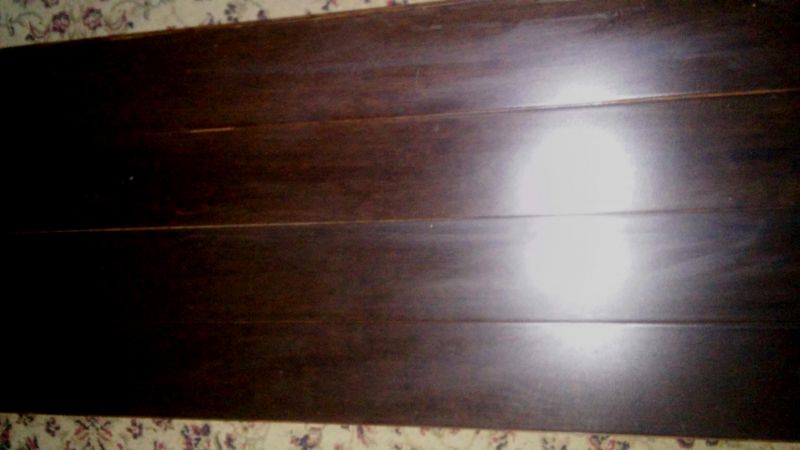

First floor was this dark stuff, was sitting on the slab, no nails, no glue, just lifted it up. I'm not sure it's even wood, maybe some composite, but it's incredibly heavy and harder than rock. I have about 800sf, mostly 6 footers. The tongue and groove are complex, L shaped and lock into a corresponding groove in the adjacent board. Maybe it's not even supposed to be nailed?

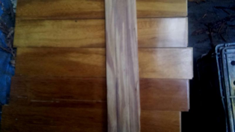

Second floor was the lighter stuff, it's wood but also very dense. Had nails in the tongues only. Got about 500sf. Both are about 1/2" thick.
My cabin interior is still studs and insulation. So I'm wondering, would it be OK to use for wall paneling? The cons are it's heavy, and the dark stuff wouldn't brighten up the cabin any. The pros are I already have it and it's stacked up in the cabin loft right now.

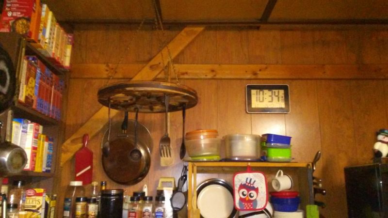

I used some flooring on the wall in the kitchen.

# Posted: 27 Nov 2018 08:23am
The stuff I have in my cabin was a removal from a flooring buddy who did a water leak repair, the lady wanted all new lighter stuff. Its supposed to just float, some on an underlayment pad, some use no pad. It just clicks in place. If you ever have a leak, its so much easier to remove and make repairs and if your cabin sets over winter unheated, it stays put.

Thanks guys. Darz that looks great. Ok so this dark stuff is not designed to be nailed in? Too me it would looks less like flooring on the walls than the lighter stuff which I think is narrower. Wonder how I'd keep it on the walls? I'm thinking I would go horizontal with it since it's shorter than the walls. Other thing is hanging pictures, shelf racks etc. Guess I will test putting nails through it and see what happens.
# Posted: 27 Nov 2018 10:02am
Yeah, do that first, if its got a high plastic content it will tend to shatter......
Don't see why you couldn't do it though.....
# Posted: 27 Nov 2018 03:35pm
The first stuff sounds like a click together floating floor. I don't think it would be a problem to click it together and face nail it to the wall studs. I wouldn't want walls that dark though.
# Posted: 27 Nov 2018 05:56pm
Guess I'm the last guy to know about click together floating flooring. Maybe I'll do the first 4 feet of the walls with it, and the rest with the lighter stuff. Won't get back to the cabin to drive a nail into it until this weekend, wish I had brought a piece home. Feels super hard and brittle. And heavy as lead.
